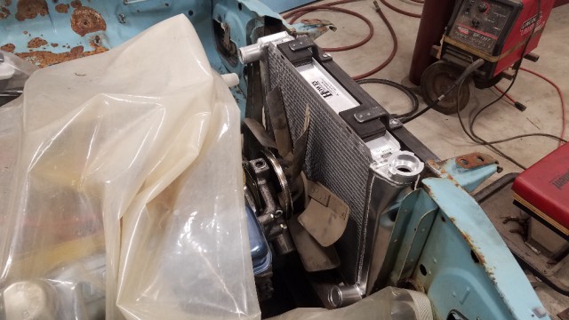

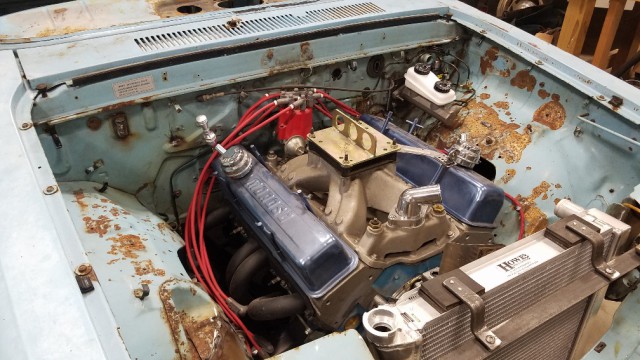

Have you cut the core support? I have seen some of the guys that have been able to keep a lot of the support. I cut most of it out then made some mounts off the bottom of the core support then added a top cross mount between the hood hinges with added braces to the radiator.

Wow! Great pics, Widetrack! Thanks! I like what you did! I'm about a 1 day a month at the moment... argh... but working on it. I appreciate the help. I'm still not quite sure how much more to cut off. I've got some cleaning up to do, then i'll start the welding (which i'm relatively new at, but have been practicing and i have a friend who is more than proficient).
