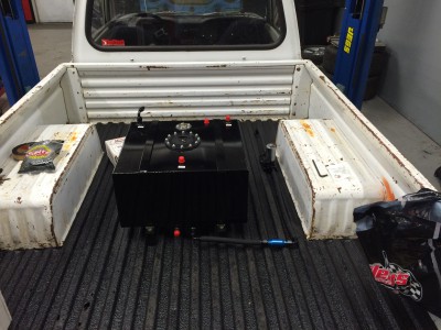

We used a 15 gallon cell from summit with an electric pump with AN10 lines to the regulator. It was a summit brand. We made two inch spacers out of 1'' square tubing to put it up off of the bed floor. I did not want to cut a hole in the bed for the sump part of the fuel cell.

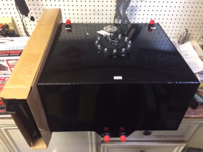

here it is mounted.

Whats the part number? Will this work for a mechanical pump??

SUM-CSUM293215SB is the part number, this is a kit with the mounting straps and yes it will work with a mechanical pump. This cell has a return inlet, sending unit 90ohms,vent outlet and two -8 outlets for fuel. You may not need this specific cell with all the inlets/outlets and sending unit. I needed but look at the others they have.
