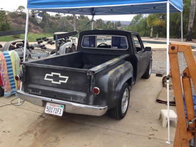

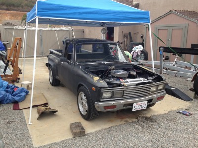

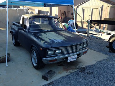

More testing and driving.
great running and driving little truck, its kinda loud...
now with safer brakes, new rear tires, fixed the diff cover leak.
Got rid of the bald 245/50/16 rear tires, new Ohtsu 225/55/16's for only $55.00 at discount tire.
ride great look good too, now they all match.
Used the rear Camaro inset wheels on the front, fronts on the back, works great.
Really fun to drive, shifts great now, lots of power cruises effortlessly...at 70-75.
Gas gauge, trans tunnel, exhaust, primer/paint to go...

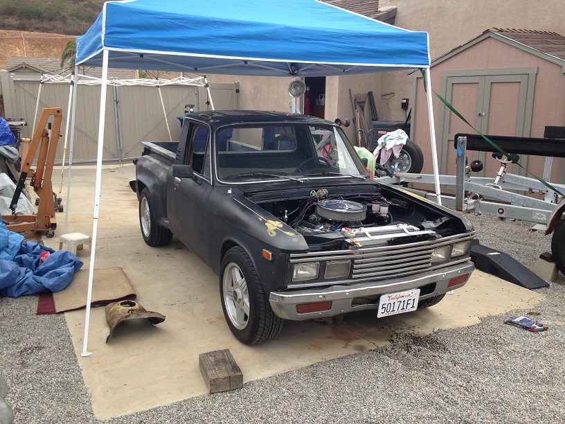

Hood fits pretty good...
bought a used hood prop rod on ebay...nice popped right in place.
as I mentioned before I bypassed the stock fuel gauge with a marine generic sender and a new sierra gauge.
I hooked up the gauge it works great, easy solution.
Gonna do the exhaust next week.
Trans tunnel being fabbed locally.
sand and prime over the holidays thru xmas.
Anyway to improve the handling on these trucks?
I am big on cornering, I do understand there is lots of weight up front.
On my old Chevy hot rods, I've done lots of suspension mods to make them handle well, plus added modern low profile BFG g/force tires. Parts are easy to find for old classic Chevys. I followed the pro-touring trends as I could afford them.
They both make the luv drive like a ....well..70's mini truck...
Maybe a rack and pinion would solve that problem?
Steering is slow and sluggish, but the box is not work out.
any suggestions?
