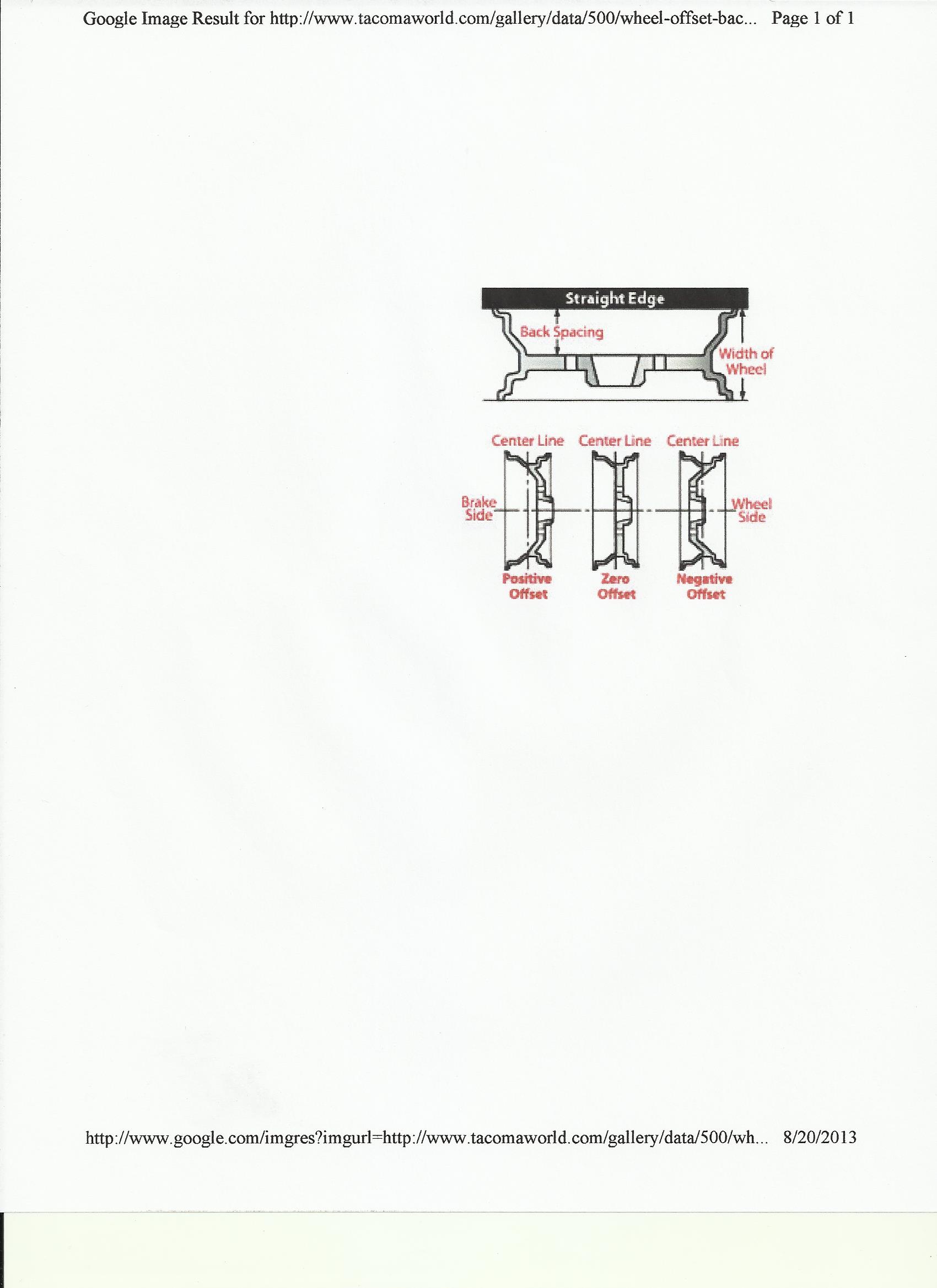

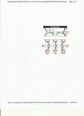

Measure from a straightedge across the axle mounting surface to the frame & fender lip, then use the attached backspace chart & the wheel width to determine what will fit. Remember the tire will protrude past the wheel rim at least 1/2" & that under hard cornering the axle can shift sideways a bit.
