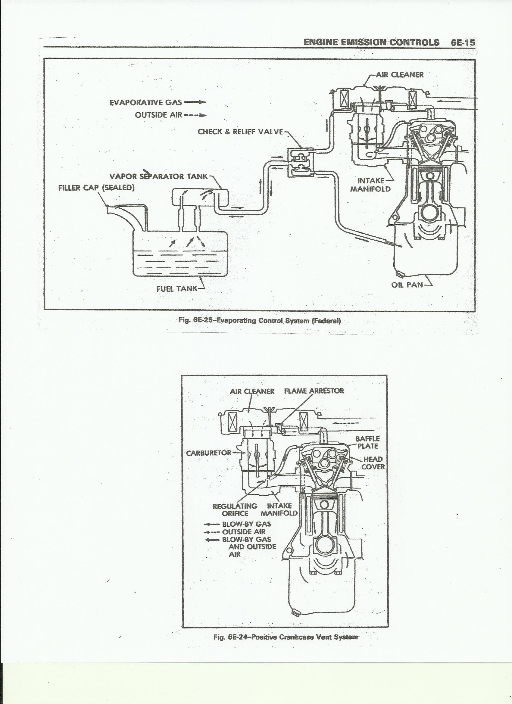

PostPosted: Fri Dec 12, 2014 11:56 am
Posts: 906
Location: N W Arkansas
See the attached for the hose routing. You can substitute a small breather filter for the large hose that comes from the air cleaner into the rear top of the valve cover, but I would not disable the PCV system, you will get oil vapor seepage from crankcase pressure through the filter(s) or the dipstick tube.
The PCV "valve" on a G180Z is not a valve, it's a regulated orifice that only needs to be kept clean & open, so I'm not sure how or why you "changed it". The hose hookup is on the center of the intake below the carb where vacuum then pulls filtered air into the top back of the valve cover while expelling crankcase vapors (including fuel vapors if the line into the oil pan is connected properly) into the fuel/air stream to be burned. If the fuel vapor line into the oil pan is not connected properly plug the oil pan connection or the PCV will suck unfiltered air into the crankcase. If you're running a Weber you may not have the fuel return system functional.
You also need a good strong vacuum to the distributor advance, but not much else.
I hope you have noticed the oil level does not indicate properly the first time you pull the dipstick- you have to reinsert it & remove it a second time or the oil level will read low. Make sure the oil level is not too high, this will also cause oil seepage.

PostPosted: Fri Dec 12, 2014 1:44 pm
Joined: Tue Nov 22, 2011 2:48 pm
Posts: 37
Location: Roseburg, Or
I was getting oil seapage out of the dipstick tube, I pulled off the crankcase breather line(that was attached to the valve cover for some reason) and that stopped the oil from leaking. I still have that crankcase breather hose on the motor, just pulled it off of the valve cover... think the kid who had the pickup before me put it there for some reason I do not know. I am not using a fuel return line either, got that plugged off. I just plan to put the crankcase breather line to a filter, and probably still use the PCV system. The pickup when I got it had a PCV valve on it on the valve cover, if they did not come with one then I will remove it... my '87 BMW was like this, a hose from the valve cover straight to the intake manifold with no valve. I just pulled the PCV valve that was on it off and replaced it at the auto parts store, I have no problems removing this and have a straight through hose.
PostPosted: Fri Dec 12, 2014 9:01 pm
Posts: 37
So that crankcase breather line, since I do not have a fuel return system. You suggest to just plug it up?
What is the little hose fitting on the carb side of the valve cover suppose to go? Is that the line you mean is suppose to go to the fittings bellow the carb on the intake manifold? I did cut off and plug those holes... I do have a secondary vacuum port on the weber, near where the vacuum advance line goes... could I put it there if needed?
I am going to remove the PCV valve tomorrow, and run it straight to the air cleaner on the carb. I may put a breather filter on it, not sure yet, depends on how it does tomorrow.
