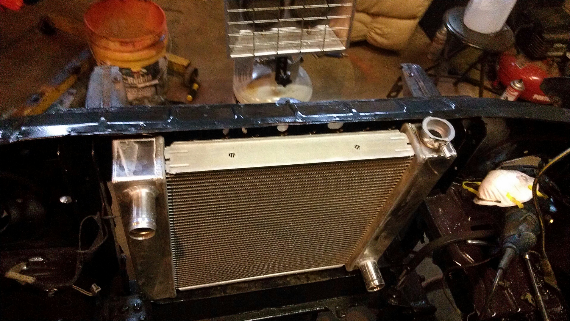

So guys, as the engine sits inside the truck, I can get by without cutting into the firewall for the hei. But, I only have like 1/8" clearance for the radiator, and that's if I angled it. Are you v8 guys cutting into the core support for the radiator? How do I get everything to fit? Thanks in advance

PostPosted: Tue Feb 11, 2014 12:54 am
Posts: 370
Thank you for the help guys! Got the radiator in today, pics will be in build thread. but still need a little more room. Will be working on getting the mounts to push back the motor 1" tomorrow. While we are on topic of v8 swaps, what are you guys running for throttle linkage/cable setups?
