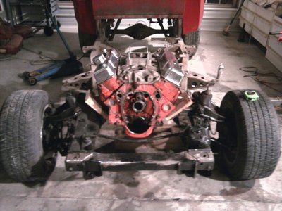

doing a 4x4 to 2x4 conversion lately just going to reindex the torsion bars and removed the front axle and shafts. looks good enough for me. made some caps for where the cv axles went in he hubs.
