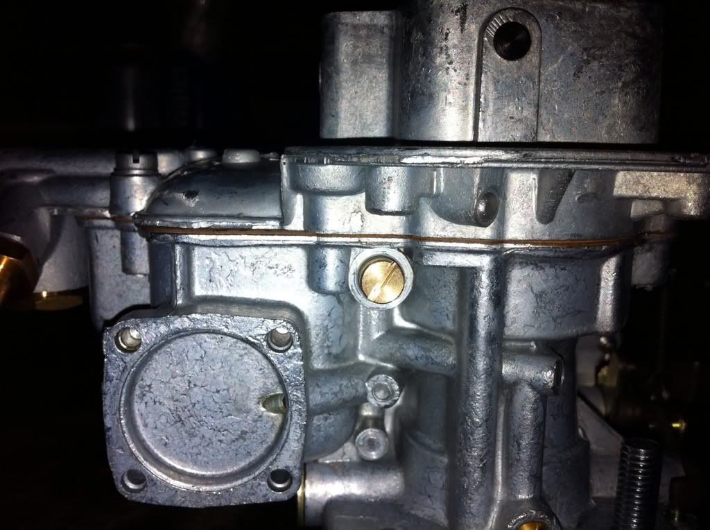

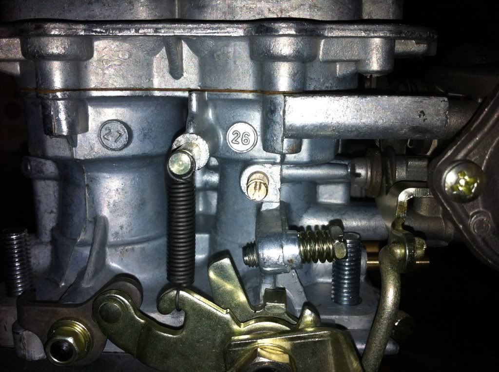

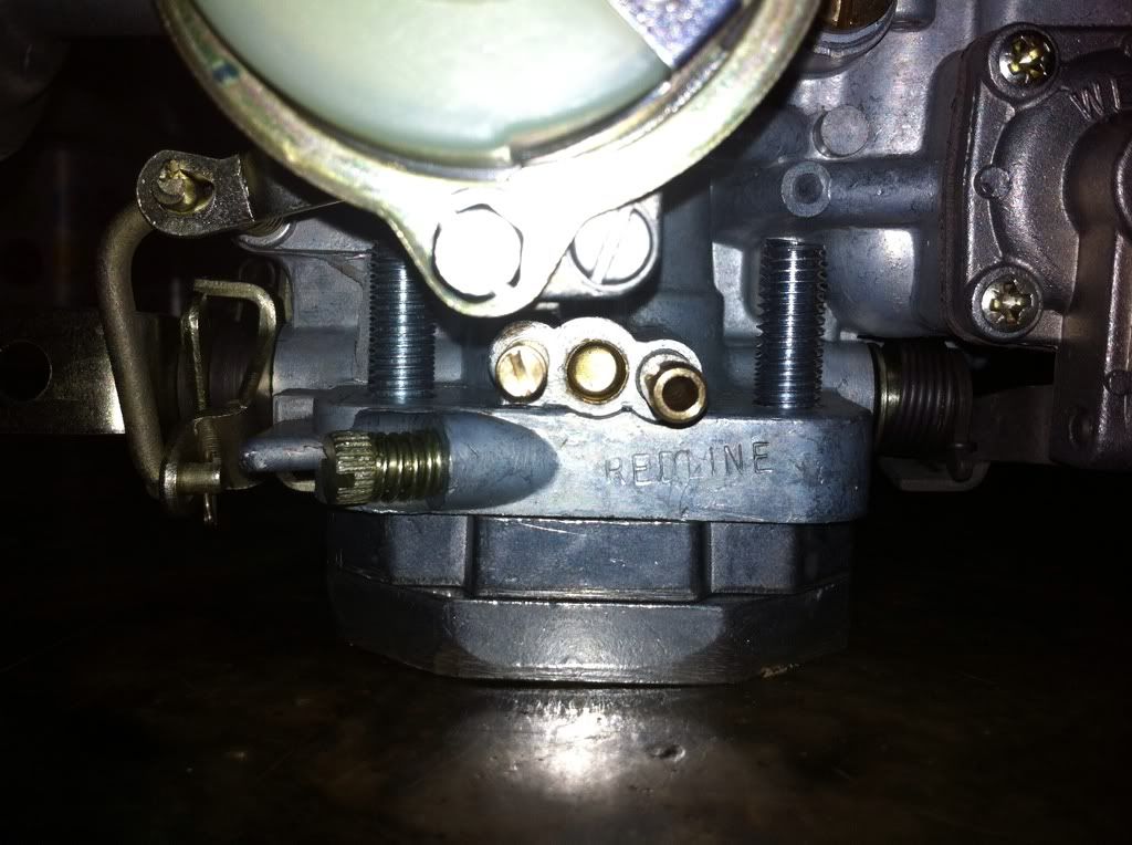

Got my 32/36 today, have a couple questions...
I'm assumeing the fuel inlet can be switched side to side, depending where your fuel line is coming from, just dbl checking here don't want to throw anything out of spec. Image
There is 1 "capped" port(instructions say for EGR if used) just left of the Dizzy Vac port underneath the elect. choke.Image There is also another "capped" port above the idle set screw, but instructions don't mention it's functionality(if it has one).Image
Is plugging the EGR holes inside the mani nessecary? I need to keep it smog legal(atleast every 2yrs, either put old carb on and hope or try to hide the weber). Has anyone hooked up a 32/36 with all the emission system in tact?
I see a spot for an Idle Cot Off solinoid, just left of the elect. chokeImage
and another capped port on the other side of the carb, slightly smaller.
Is there a coasting valve solinoid option for the 32/36? And or is it nessecary for a smog test?
 Post subject: Re: Weber 32/36
PostPosted: Wed Nov 02, 2011 1:36 pm
i made a plate i bolted over the egr port on the intake manifold so i wouldnt have a massive vaccuum leak.
the ports i didnt need to use i just popped some vacuum plugs on

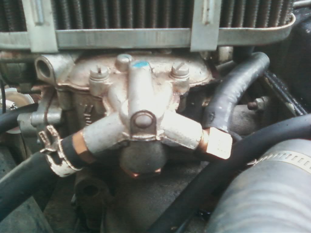

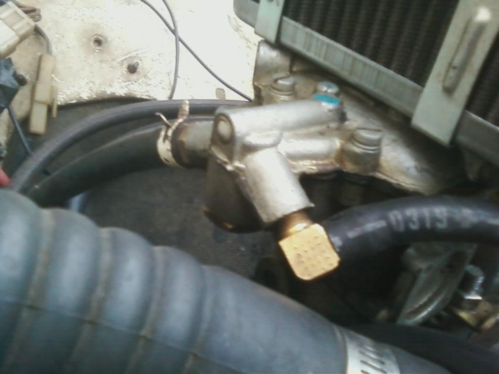

alright finally got out to get a couple pics
feed comes in on the left side of the pic. return at a slightly upward angle on the right.. i used the original lines from the truck and moved them around. its a close reach but they made it.
grabbed the fitting at o'reillys for the return. real easy to set up

Looks good, did you use and thread tape or thread sealer on that fitting or did it snug up at that angle? The fittings I got have the tapper on them, so I don't want to over tighten it and crack the aluminiun..., Would some Teflon/thread tape be ok to use on this fitting?
PostPosted: Sat Nov 05, 2011 1:58 am
i dont remember using any but it should be just fine to use.
if you have it use it and have the peace of mind
