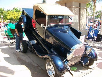

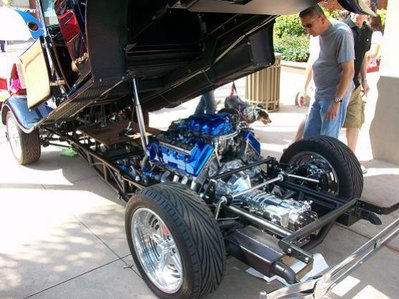

Here is proof it can be done, not exactly mid engine. This was at the Fullerton Car Show today.
 Post subject: Re: Mid-Engine Luv 0.o
PostPosted: Sun Oct 03, 2010 2:03 am
Posts: 773
Location: Caldwell ID
i thoght mid engine. was like that the engine just in front of the back tires?
PostPosted: Sun Oct 03, 2010 9:33 am
I agree. Behind the driver and in front of the rear wheels, is mid-engine. Think Pontiac Fiero, or Toyota MR2. So that old pickup would be considered mid-engined. Fullerton huh? Too bad I didn't know about it, and had to work. :cry: :cry:
PostPosted: Sun Oct 03, 2010 10:02 am
That makes sense, I guess you guys are right it is mid-engine. It was a smaller show this year.
