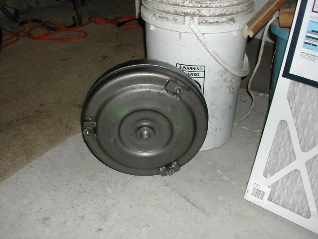

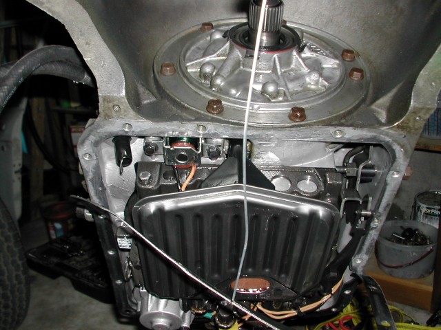

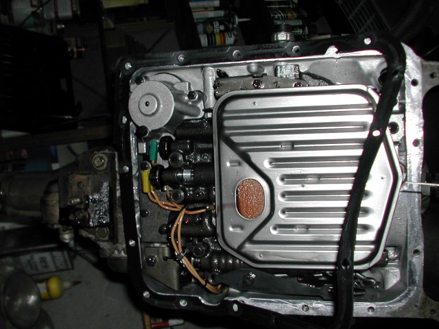

ok here is some pics/ I guess it is a lockup since it has the wiring right. Do I need to run a toggle switch if I want to lock it manually in a gear. will they work without a switch.
Guess the pics are little big. Don't know how to shrink them.
I just figured out I have over 5,000 in this truck with the motor and tranny and it is still just a rolling chasis and a bunch of parts. Bummer :( :roll:

The trans looks like new and that is a lockup converter. Yes you can wire the converter to a toggle switch and lock it up when you want.
