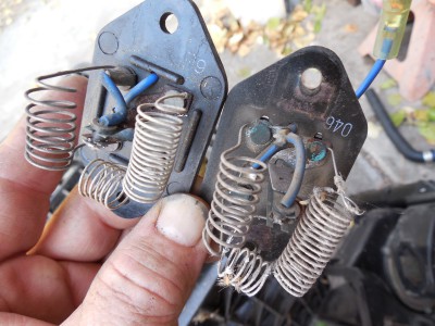

Check the resistor ... i guess there are 2 , 3 wire plugs (lo med hi Speeds) ..I'm still playing w/ mine its down & by passed temporary
here's the 3 plug one i pulled from my 80 4x to test in my 77 they looked the same w/ 3 plug.
