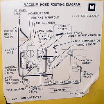

Here is a pic of my 79 Vac Diagram
Maybe it will help
Jim

No fair! its like Bullwinkle drew the one for cali!

I got a good shot of the vacuum routing diagram for the '81 luv down at the local Pull & Save. Stopped by yesterday to see what other parts I could confiscate from it and brought my camera just in case. I'll post it up tonight when I get home
