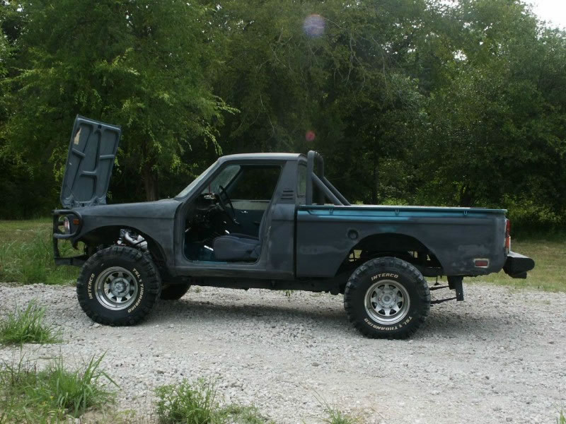

I've got 31's and had to cut the fenders. This is what you have to do for 33's.

we have 10.5x31,s on our 80 and had to trim the fenders a little. it has a 3" body lift :new-alien:[/img]
