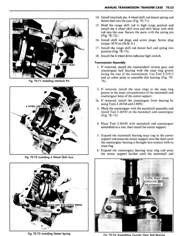

I'm not sure if this is the correct spring, but I have more pictures of the transfer case diagram. Hope this helps.

Thank you for the reply. The spring I am referring to is external, and fits just under the boot on the transfer case shift lever

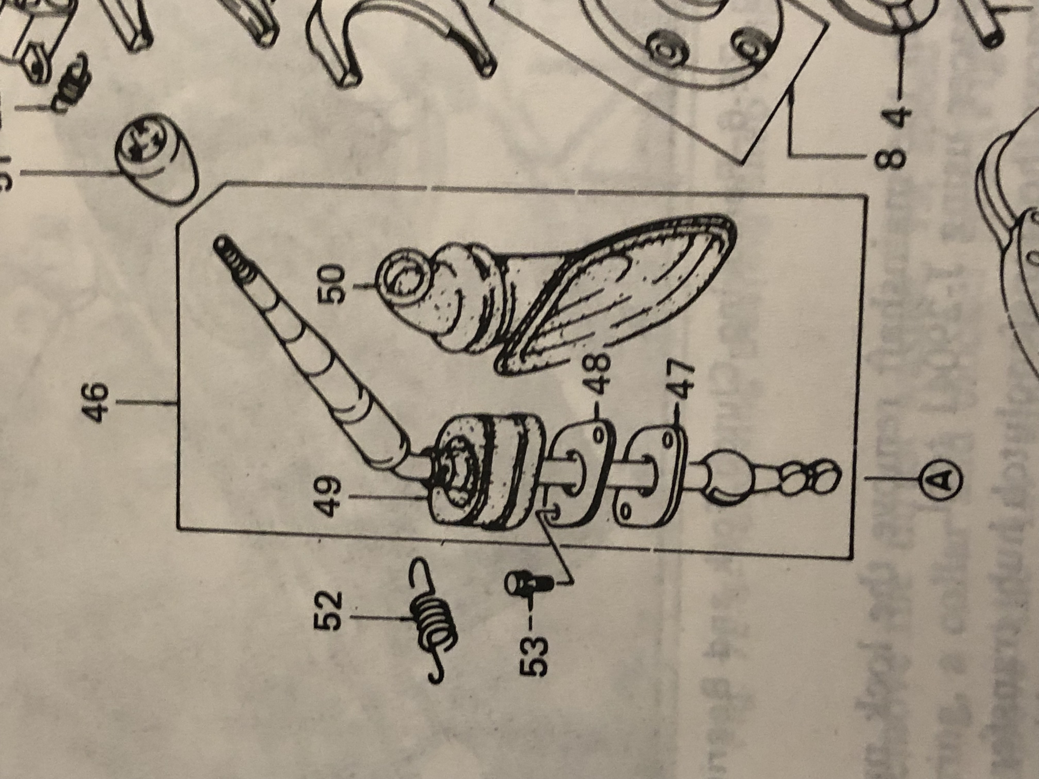

]Have checked all the local shops. Nobody remembers working on one. If someone with a rig sporting a 4 speed with transfer case would be willing to lift up rubber boot and take picture of spring in place, I would be grateful. The spring is shown iin section 7E-5 of the Chevrolet Series 10 shop manual, and listed as item 52 "spring, return, gear shift lever"
