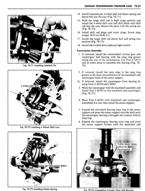

I'm not sure if this is the correct spring, but I have more pictures of the transfer case diagram. Hope this helps.

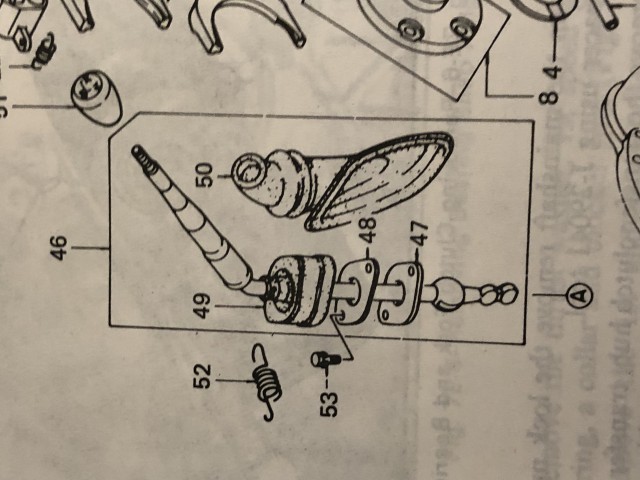

]Have checked all the local shops. Nobody remembers working on one. If someone with a rig sporting a 4 speed with transfer case would be willing to lift up rubber boot and take picture of spring in place, I would be grateful. The spring is shown iin section 7E-5 of the Chevrolet Series 10 shop manual, and listed as item 52 "spring, return, gear shift lever"

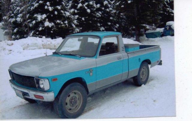

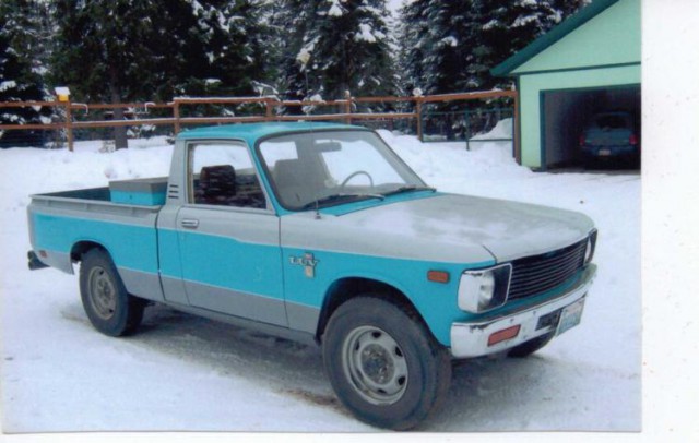

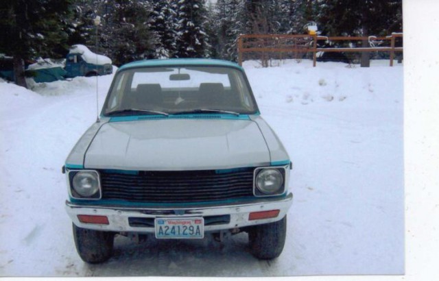

Here are a few pictures of the truck that is waiting for information on the transfer case return spring. I sure would like to solve this problem before snow falls this year.

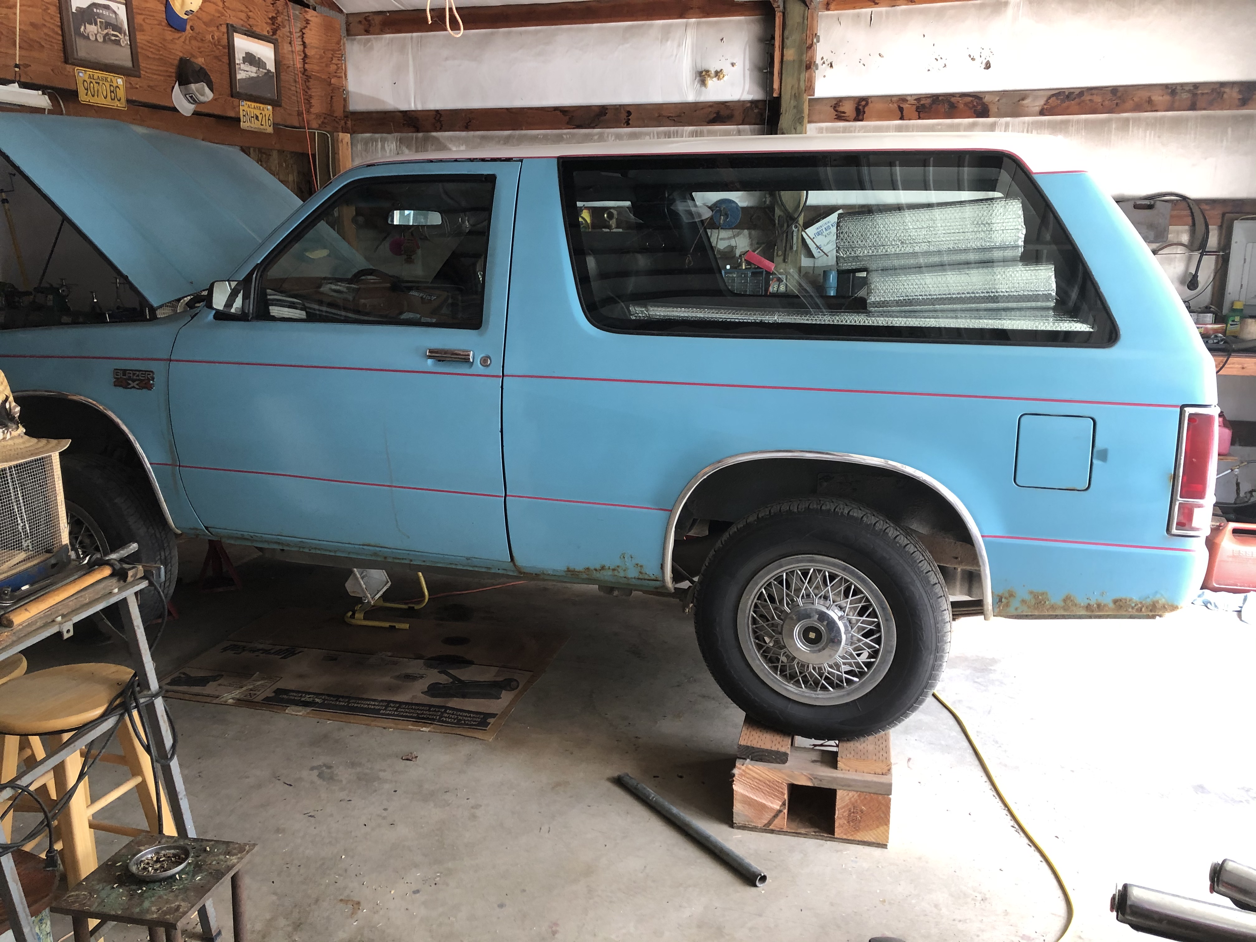

Les Schwab in Rathdrum, Idaho acquired the 15"wheels for me in 1995. The 14's that it came with were taxing the engine at freeway speeds, so I lessened the burden a little. The paint is a result of several attempts at different color schemes. I have an 83 S-10 Blazer 4x4 with a different array of the same Robin egg blue that I restored for my grandson.
I really appreciate your help trying to locate the return spring, but if your transfer case is removed from the vehicle, the shift lever will probably not be intact with the spring in it's proper position.
