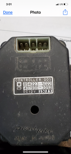

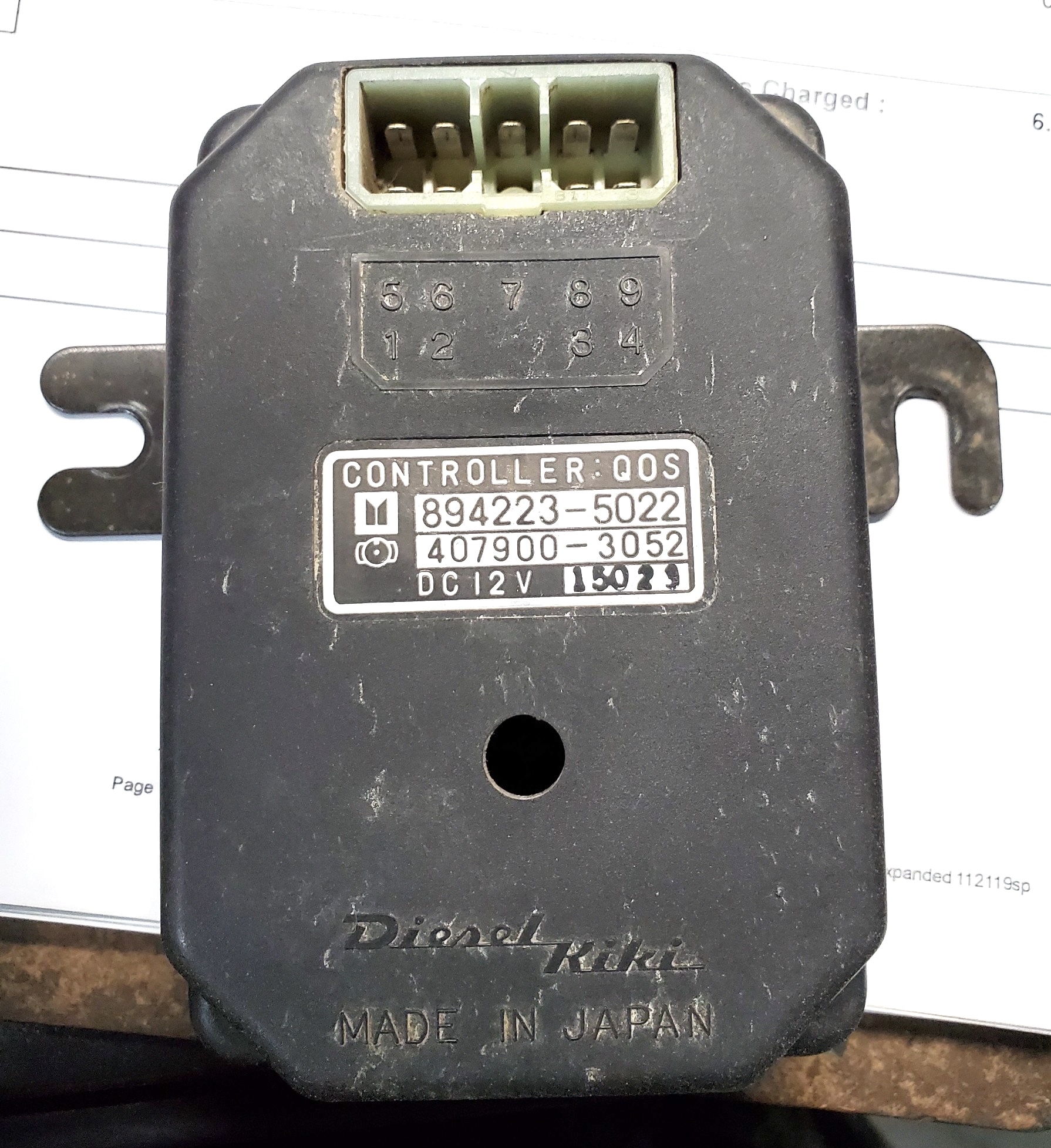

I have an ‘82 2.2L diesel LUV. Have been looking for a replacement glow plug control module. There are 9 pins that 3 different wiring harnesses plug into. Any help would be greatly appreciated!

I think sqdeb@yahoo.com should have this (salvaged).
But before you spend the money for it, wanna do some troubleshooting? These are generally pretty reliable, and quite often they're incorrectly blamed for glow issues.
What's going on with yours?
