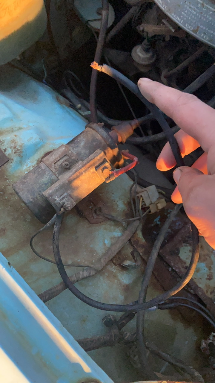

1978 LUV
I’m trying to figure out what this wire I’m holding goes to, if it’s even a stock wire. Is this a ground wire?or show me a picture of what your wires look like
Any help is appreciated

take it off. mine only has the one wire from the loom going to that post. for a short time I ran a fuel pump connected right there because it gets power from the ignition. someone probably used that spot like I did and left the wire.
Hmm, I can’t get mine started and I wonder if it’s the same issue.
