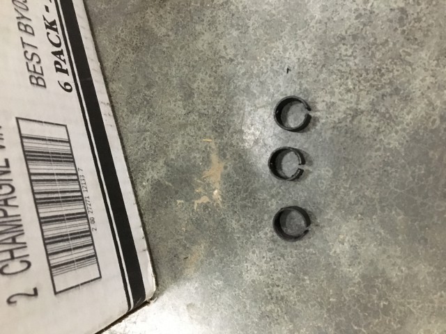

Good day all, I recently took my head and block of my 79 Luv to get checked, hot tanked, etc. The company had to take off a couple spare parts. Could anyone identify what these are and where they go? Thanks

Alignment dowels that fo into the block for the head to align to??

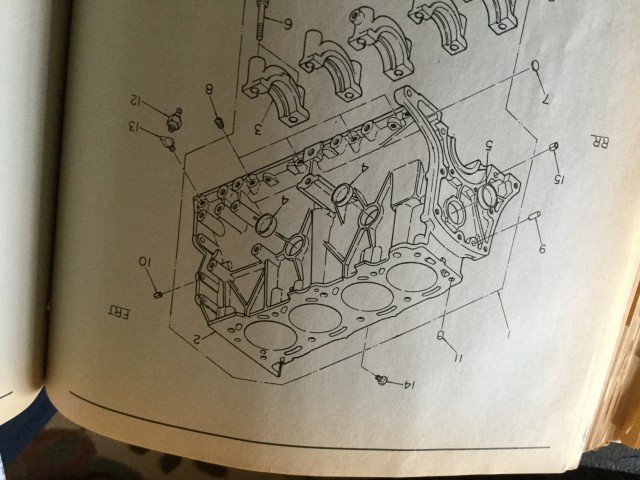

#11 possibly

they look like the alignment dowels that go into the head. Your head gasket will go over these. My 77 had only two, I see 3 in the picture. You will have to pull your head back off to check. Dale
