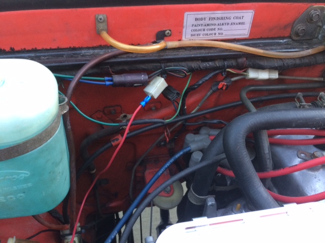

I am trying to get my windshield wiper pump working but I can not identify the correct wires?
Does anyone have a pic or the color of wire to look for?
This is what I am working with...

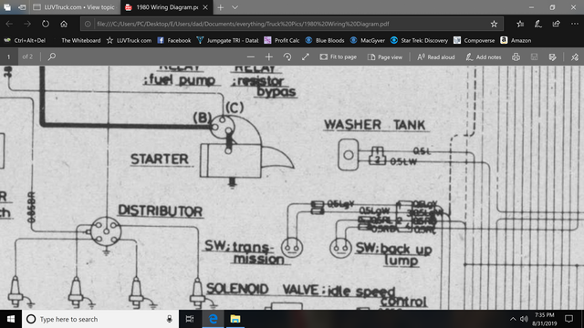

Looks to be the light green with white and a light green are your washer wires.
If you give me your email I can send you the .pdf of the entire wiring diagram. Mind you, the one I have is for a 1980. Not sure what year you're working with.
