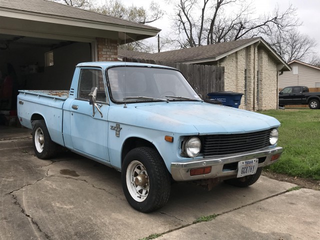

I have a 1979 that was starting and runnig. be runs very choppy and stutters alot. so i attempted to move the timing a bit and i think i got the timing off.
Because no she wont start at all.
any advice on reseting the timing? Finding TDC and so forth?
Thanks!!
