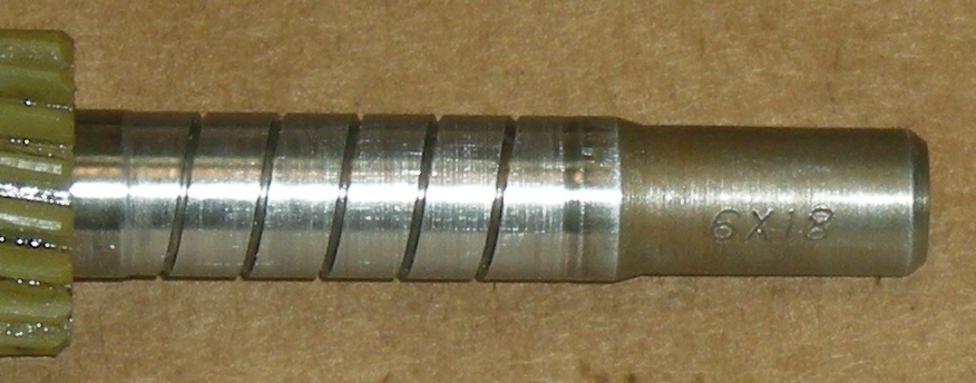

I'm surprised your gear doesn't slide right out. Mine did. Here's what the shaft looks like.
The o-rings inside the housing look like the same type used in air conditioning systems. I can't remember if there is one, or if there are two inside. I got mine from a hardware store. You have to be careful not to get one that's tight enough to bind the shaft from turning freely. That would cause excessive wear on the nylon gear.

Gear shaft came free with some gentle hammer and nail sink coercion. Looks like a single o-ring inside. It's kind of tricky to get fine measurements for a super flexible rubber o-ring unfortunately (at least with a micrometer), but here are my measurements:
OD: ~15mm
So that leaves a ring thickness of 2mm which squared up with what my micrometer said. I may skip the replacement of the external o-ring the more I think about it. It looks like it's in pretty good shape, and the gear housing didn't seem to be leaking -- just where the cable entered (i.e. a bad inner ring). I'll see what I can find for rings. Will post here when I find some replacements.
