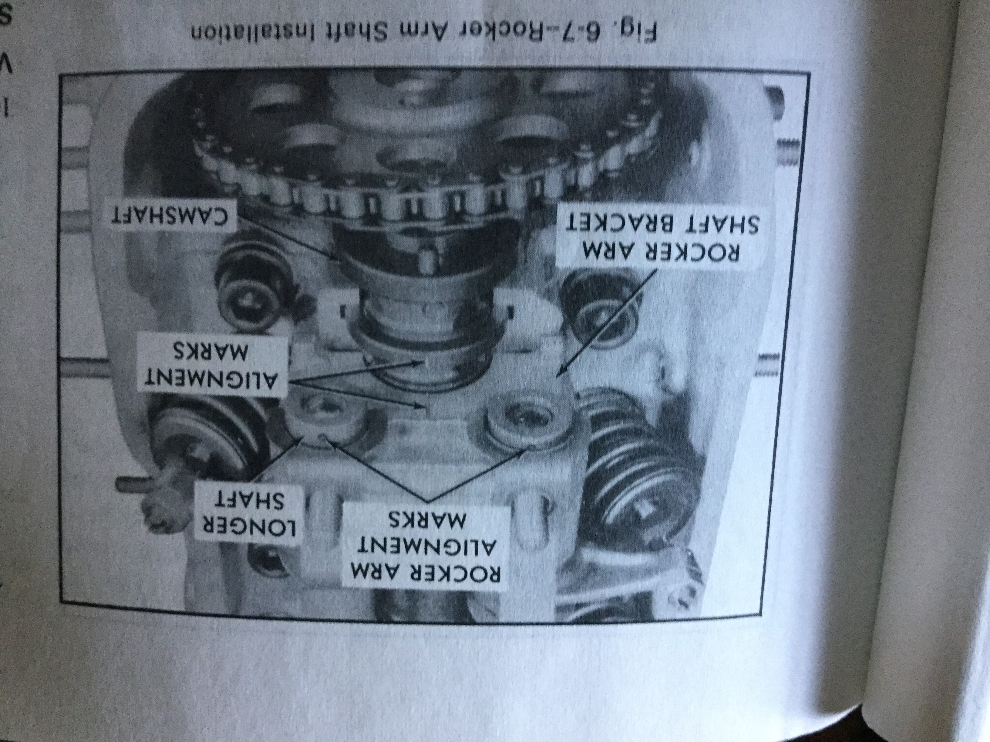

From the manual, this is a easy and quick way to check cam timing
Bring the camshaft mark to the mark on the #1 rocker arm shaft bracket. See if the crank is on the TDC mark and distributor is pointing to #1
