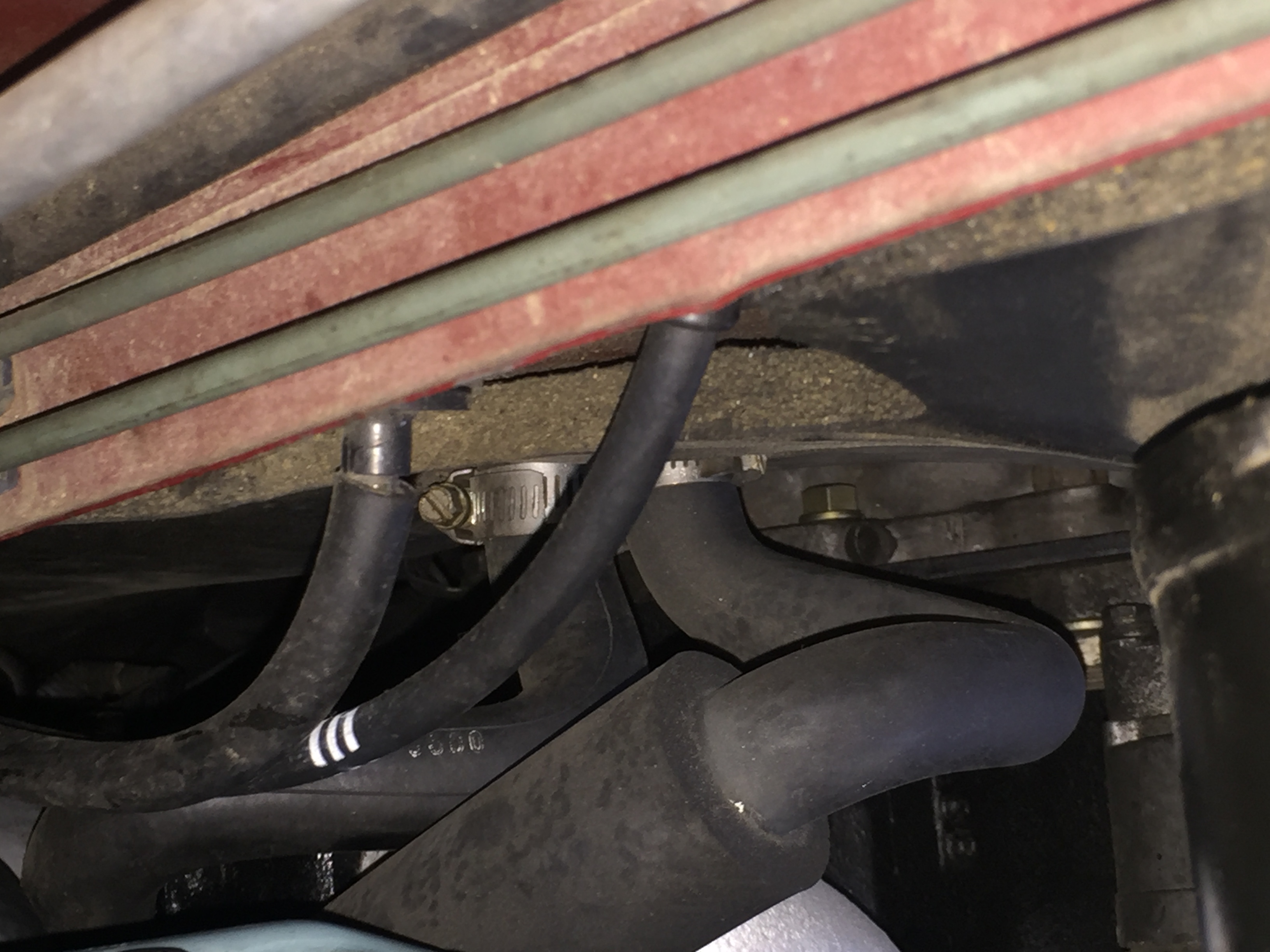

I'll see if I can get a good pic this afternoon. My '83 P'up is the same.
 Post subject: Re: heater core
PostPosted: Sat May 05, 2018 4:14 pm
Posts: 1702
Here's the best pics I could get without removing the air cleaner. If you click on each image, it should appear right-side up.

Thanks guy got it hooked up and it started leaking again back to the drawing board
