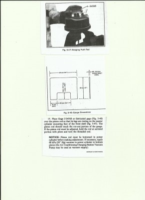

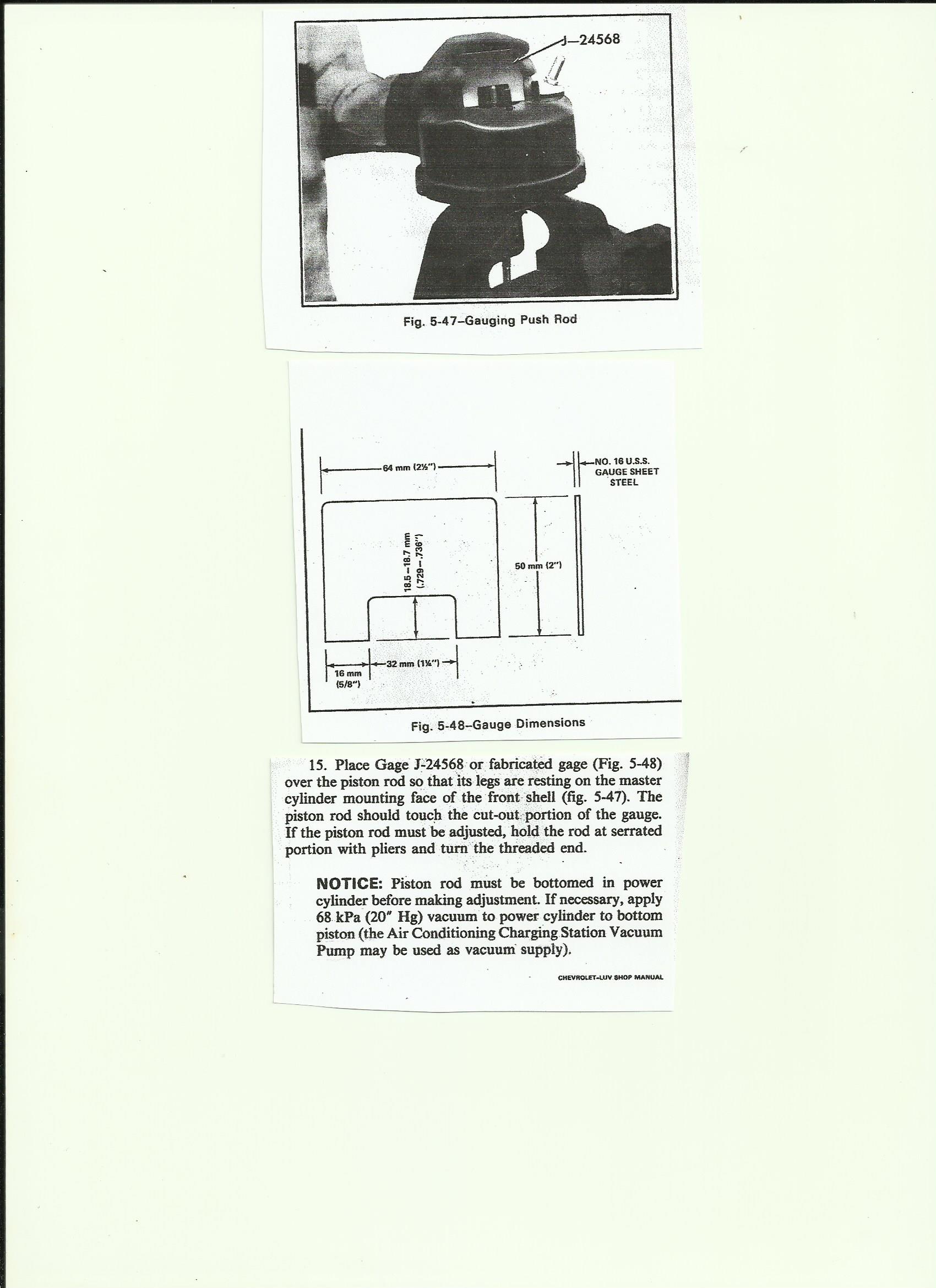

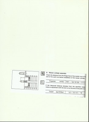

There is a rod between the brake booster & master on disc setups that must be adjusted to an exact length in order for the master piston to travel the correct distance with each stroke of the pedal, I assume the type same adjustment is found on drum applications . A FSM will have the dimension, it will be similar to the attached pictures. I fabricated a test gauge/tool from aluminum flat stock, but a credit card would also work.
