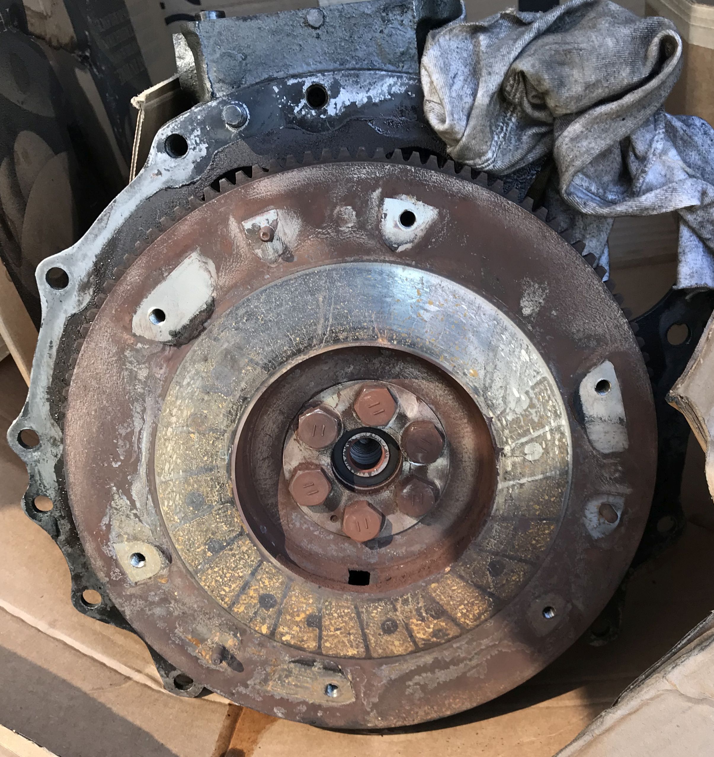

Ok thanks, here is my flywheel.
I believe any will work based on the info above, just thought I'd double check.

Sorry I read the post above wrong, it looks like this is the clutch for my 6 bolt flywheel. My current clutch is definitely the 7-7/8s" clutch.

Posts: 906
Location: N W Arkansas
FYI you can get either of the clutches in the link for quite a bit cheaper. Both rockauto.com & ebay have either for around $100 shipped, so shop around. Ebay also has used 6-bolt flywheels for the 8.5 clutch should you want to upgrade, just be sure what you buy fits a G200Z 1.9 engine.

Posts: 906
JoeIsuzu wrote:
I don't think he told us WHICH 5-speed 4x4 transmission he has. There were two different transmissions, depending on the year of the Trooper. The '86-'87 Troopers used the MSG-5. When the 2.6L engine was introduced in '88, the MUA-5 transmission was mated to it. Does that matter in this discussion?
Not really, for a 1.8 or 1.9 GxxxZ series engine you have to match the clutch to the flywheel being used, much the same way as if using a 2.3 or 2.6 4Zx1 series flywheel: different flywheels have different clutch attachment bolt patterns while the flywheels & trannies are interchangeable among each engine series.

Posts: 207
Location: Seattle
I do have the 6 bolt flywheel. Does that mean the 8.5" clutch will fit? I would like the biggest strongest one I can get.

Posts: 906
Thanks for the help
My block is in the shop now. I'm getting custom JE pistons made and I've got forged rods, Clive cam, and a bunch of good shit going into this. Bigger 4ZD1 valves with all the head work for the turbo.
All flywheels for 1.8 or 1.9 engines have 6 crank bolts. If the clutch you took out is a 8" then the 8.5" clutch won't fit your flywheel, to upgrade you'll need to purchase a 6-bolt flywheel for the 8.5" clutch. Like this one: https://www.ebay.com/itm/81-82-83-84-85 ... SwkNpahhOH it says it's from a 1986 pickup w/1.9 engine.

Ok thanks so much! I bought this stuff from Rockauto:
AMS AUTOMOTIVE 167030 Flywheel $ 45.89 $ 0.00 1 $ 45.89
EXEDY 04071 Clutch Kit $ 70.79 $ 0.00 1 $ 70.79
Looks to be correct!

Posts: 906
The 8.5" clutch ordered will fit the flywheel you ordered, but that flywheel is for a 4ZD1 2.3 engine, it has 8 crank bolts & will not fit your G200Z engine, which has 6 crank bolts. This is one of those instances that I mentioned previously where parts suppliers don't have the correct part number for this engine, they match the flywheel to the clutch. Every supplier does the same thing, even those $300-plus aluminum Fidanzas. The problem is that 8.5" clutch was used for three different Isuzu engine series but each series used a distinctly different flywheel. rockauto does not sell the flywheel you need, they only list ones with 8 crank bolts that fit the 4ZD1 engine & don't listen when you try to tell them it won't fit a G-series engine- I've tried. And it's not just rockauto, it's every parts supplier I've looked at.
See if you can cancel or modify the order so you don't have to pay return shipping. If you want the 8.5" clutch upgrade you'll need the correct flywheel, the ebay link I posted previously is for what should be a correct used one, I got a new one from jlemond@bellsouth.net, seems like it was around $100 & came in a flat rate USPS box.
