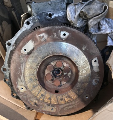

Ok thanks, here is my flywheel.
I believe any will work based on the info above, just thought I'd double check.
I'd like to buy this:

Sorry I read the post above wrong, it looks like this is the clutch for my 6 bolt flywheel. My current clutch is definitely the 7-7/8s" clutch.

Posts: 906
Location: N W Arkansas
FYI you can get either of the clutches in the link for quite a bit cheaper. Both rockauto.com & ebay have either for around $100 shipped, so shop around. Ebay also has used 6-bolt flywheels for the 8.5 clutch should you want to upgrade, just be sure what you buy fits a G200Z 1.9 engine.

I do have the 6 bolt flywheel. Does that mean the 8.5" clutch will fit? I would like the biggest strongest one I can get.

Posts: 906
Thanks for the help
My block is in the shop now. I'm getting custom JE pistons made and I've got forged rods, Clive cam, and a bunch of good shit going into this. Bigger 4ZD1 valves with all the head work for the turbo.
All flywheels for 1.8 or 1.9 engines have 6 crank bolts. If the clutch you took out is a 8" then the 8.5" clutch won't fit your flywheel, to upgrade you'll need to purchase a 6-bolt flywheel for the 8.5" clutch. Like this one: https://www.ebay.com/itm/81-82-83-84-85 ... SwkNpahhOH it says it's from a 1986 pickup w/1.9 engine.
