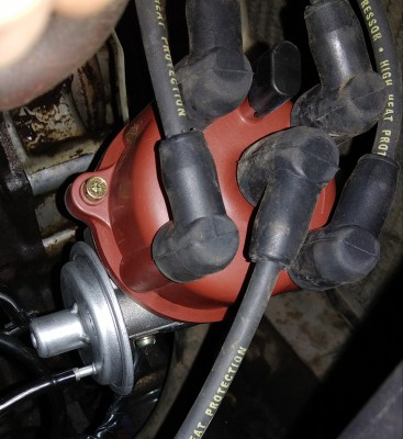

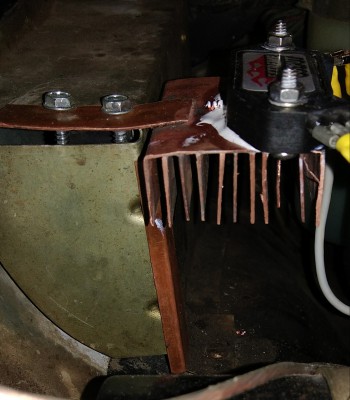

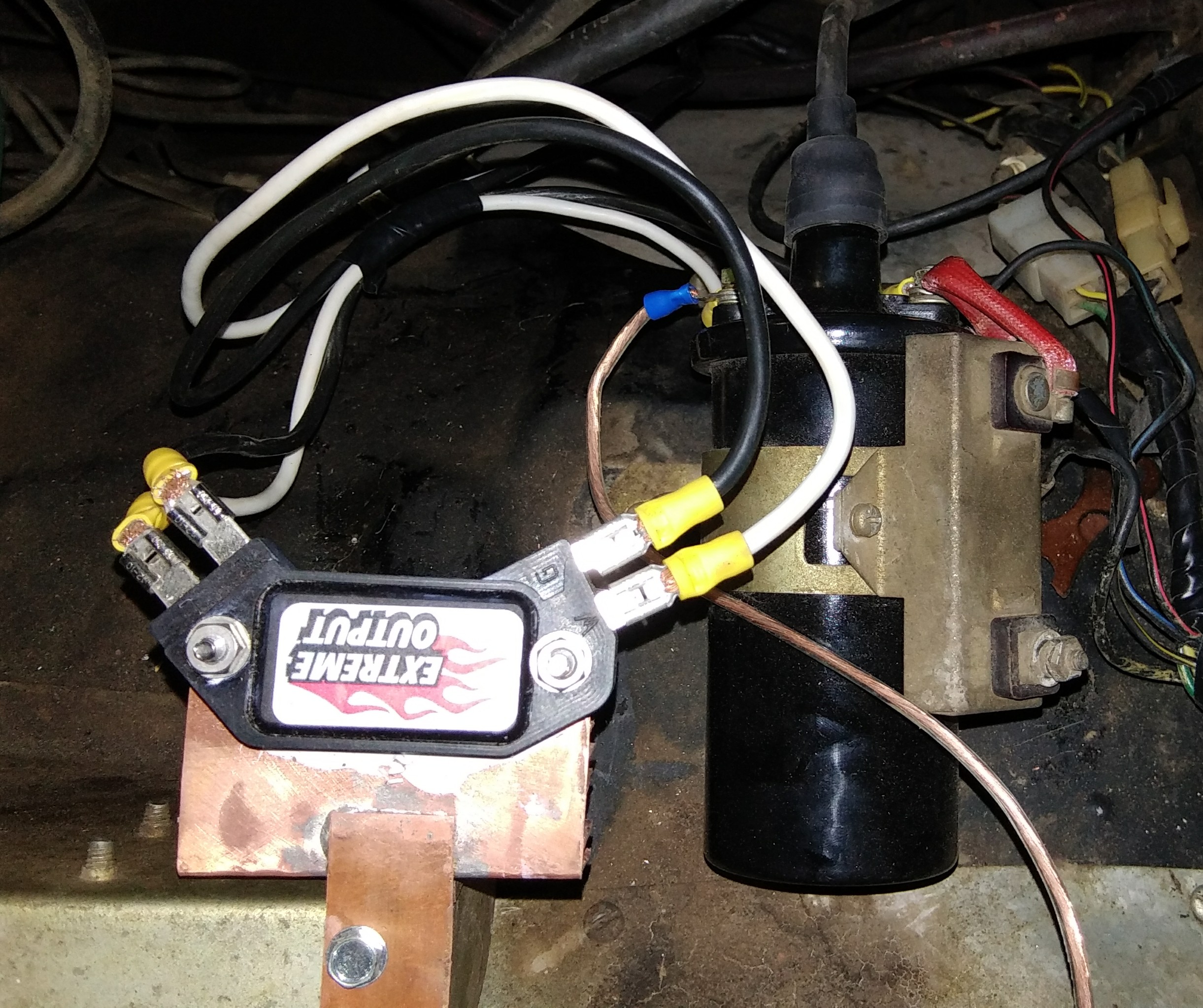

Here are a few pics.
File comment: Ignition Control Module on heatsink bracket. Mounted to relay box by coil.

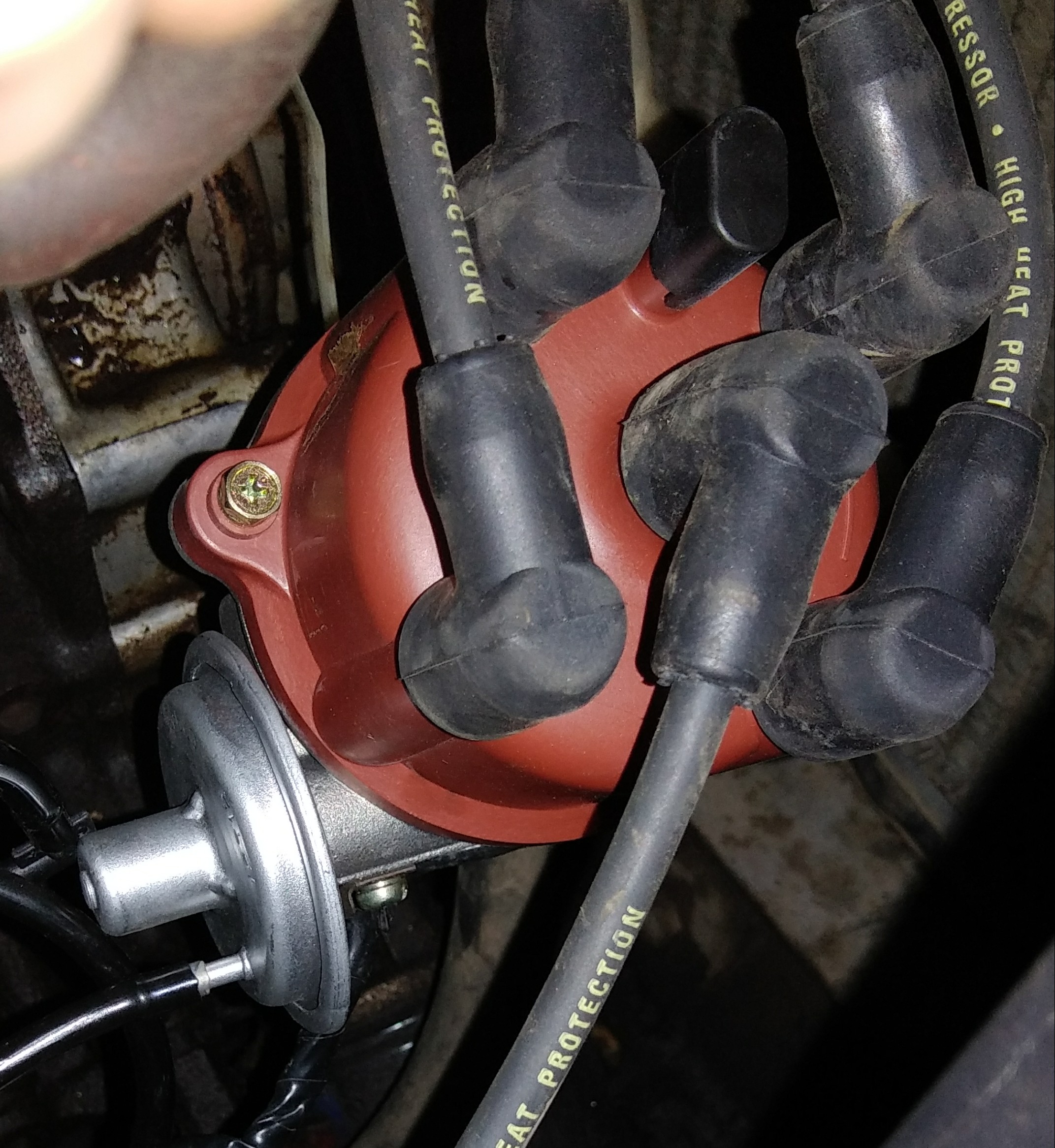

File comment: Series 11, 12 dizzy

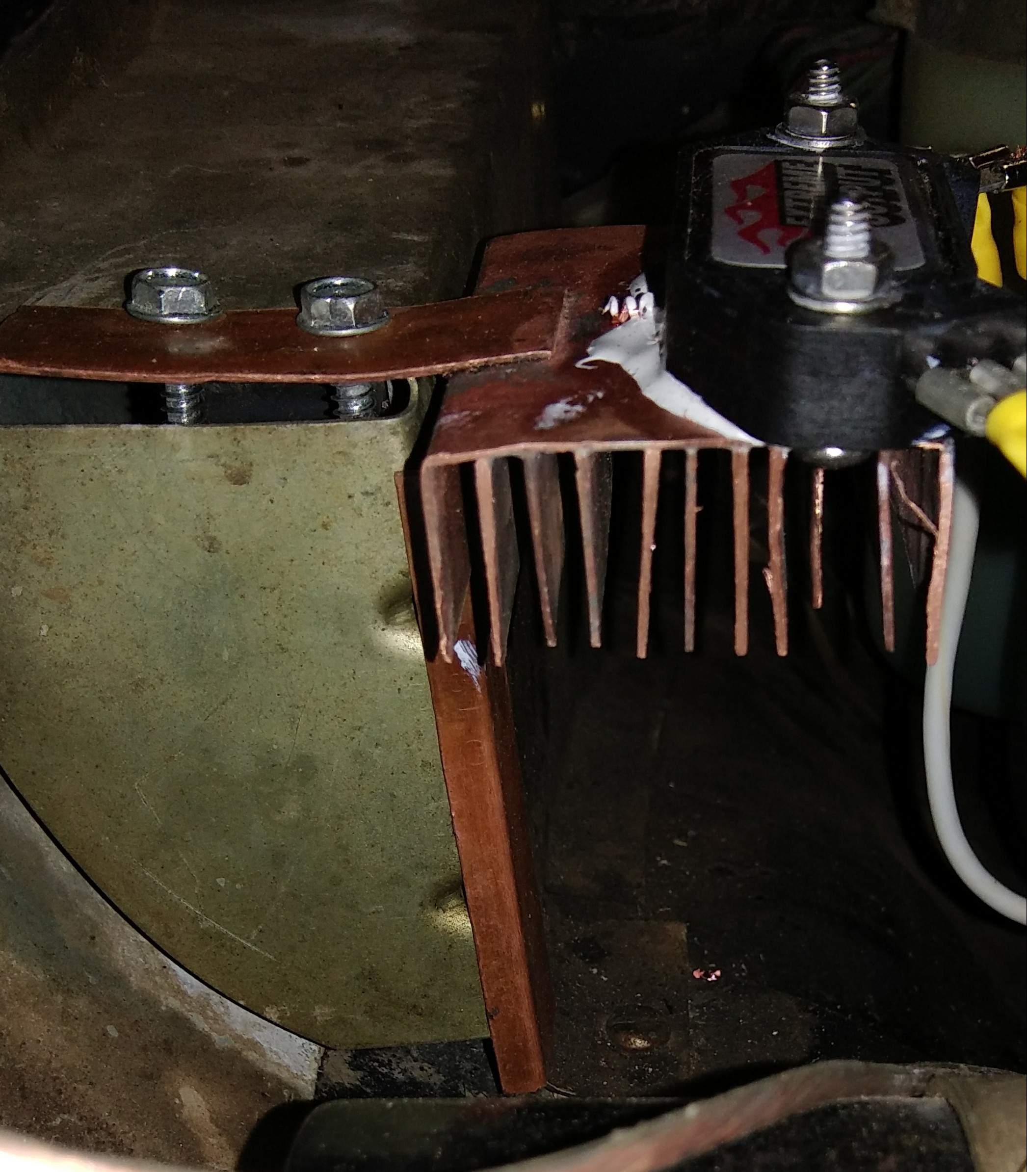

File comment: Heat sink made from copper strips soldered together

You said wires W and G go to the wires in the dizzy, that wires in the dizzy? What are you using as a reference for the igniter if you have one, are the points in line still?
PostPosted: Sun Dec 17, 2017 9:18 pm
Joined: Wed Oct 04, 2017 5:25 pm
Posts: 39
Location: Kansas
The magnetic pickup in the distributor has two wires coming out of it. Those wires need to go to the W and G pins on the ignition control module. As far as I know it is as simple as that (unless I just got incredibly lucky). What do you mean when you ask if the points are in line still?
As a side note I completely bypassed the ballast. It is still there in pictures but, as the technical bulletin I read that was posted on this site said, it is unnecessary. I just haven't removed it yet.
