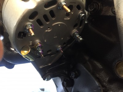

I should have taken a picture of the 60amp alternator before I installed it. Here it is anyway. Connections seem to be straight forward. The VR two wire plug, then 12v and ground. Do you guys agree to what you can see as far as connections. What threw me off is that the condensor is hooked up to where I think the 12V connection should be and the ground goes to the screw that has the Phillips head on it?
There is another single pin connector that shows a "P". Any idea as to what that might be. I'm trying not to mess this up. The new VR comes in tomorrow.

Or the "P" is for 12V and where the condensor is wired is the ground?

I was told BA, which is connected with a condensor is for 12V, the "P" is for the gen idiot light and the E is for ground.

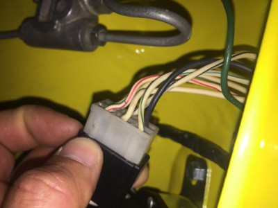

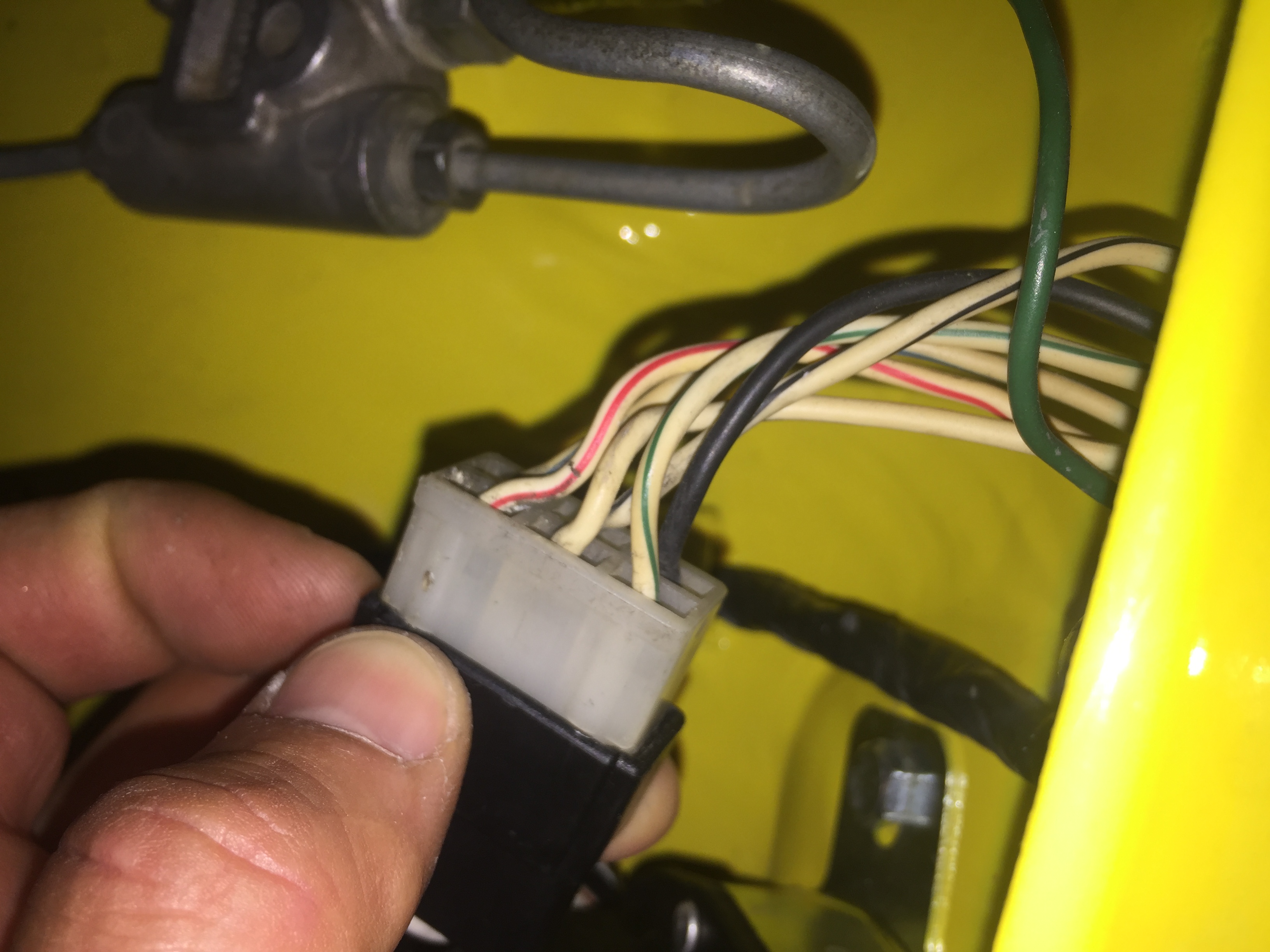

I was supposed to get the new voltage regulator today and was sent the wrong one. I’m trying to get one with matching wires to the stock harness. When you order the VR, pictures show correct colors but when you receive it, wire colors are different. I don’t think it matters but because of this charging problem that I haven’t figured out, I’m skeptical.
Anyone buy a VR regulator lately and notice the wire color difference? Is there a way to check A VR? The VR I have now is new along with the alternator but the system is not charging. I bought the new alternator first using the old VR. Gen light was on. I bought the new VR, installed it and gen light still on. And this is where I am now. The wire harness on this truck has not been chopped up, it’s actually nice.
Suggestions?

I’ve been spending time everyday researching on the internet and looking in the LUV manual for answers and to familiarize myself with the charging system. I’ve read a lot of posts with frustrations and with some, it has been something simple overlooked. I ordered another voltage regulator.
At the battery I show 12.59 volts. Everywhere I test, at the fuses and at the positive on the alternator, the same volts. I read on a thread where it said the white/red wire should have 14 volts and the white/green 7 volts. I don’t have that, way below those numbers. I forget the exact numbers right now.
Also, when the truck is off and key in the on position, I put the test light on the white/red wire at the harness plug by the voltage regulator, at the relay resistor and below the dash where the plug it’s on is not connected to anything. I believe it’s for the AC system that I don’t have. The test light is very dim at all three points. Is that normal? Should the wire light up bright for 12volts when the key is on without the engine being on?

Have you done the Fuse Box Repair?
It's the only thing I can think of.
 Post subject: Re: Alternators
PostPosted: Wed Oct 04, 2017 11:19 am
Posts: 262
Yes, completely cleaned when I took the harness out. Is the white/red wire suppose to test low voltage that way?
PostPosted: Sat Oct 07, 2017 6:33 pm
Posts: 262
I installed the new voltage regulator and the 60 amp alternator is working good. No problems. Hooked the amplifier back up and no problems. Thank you for your help.
