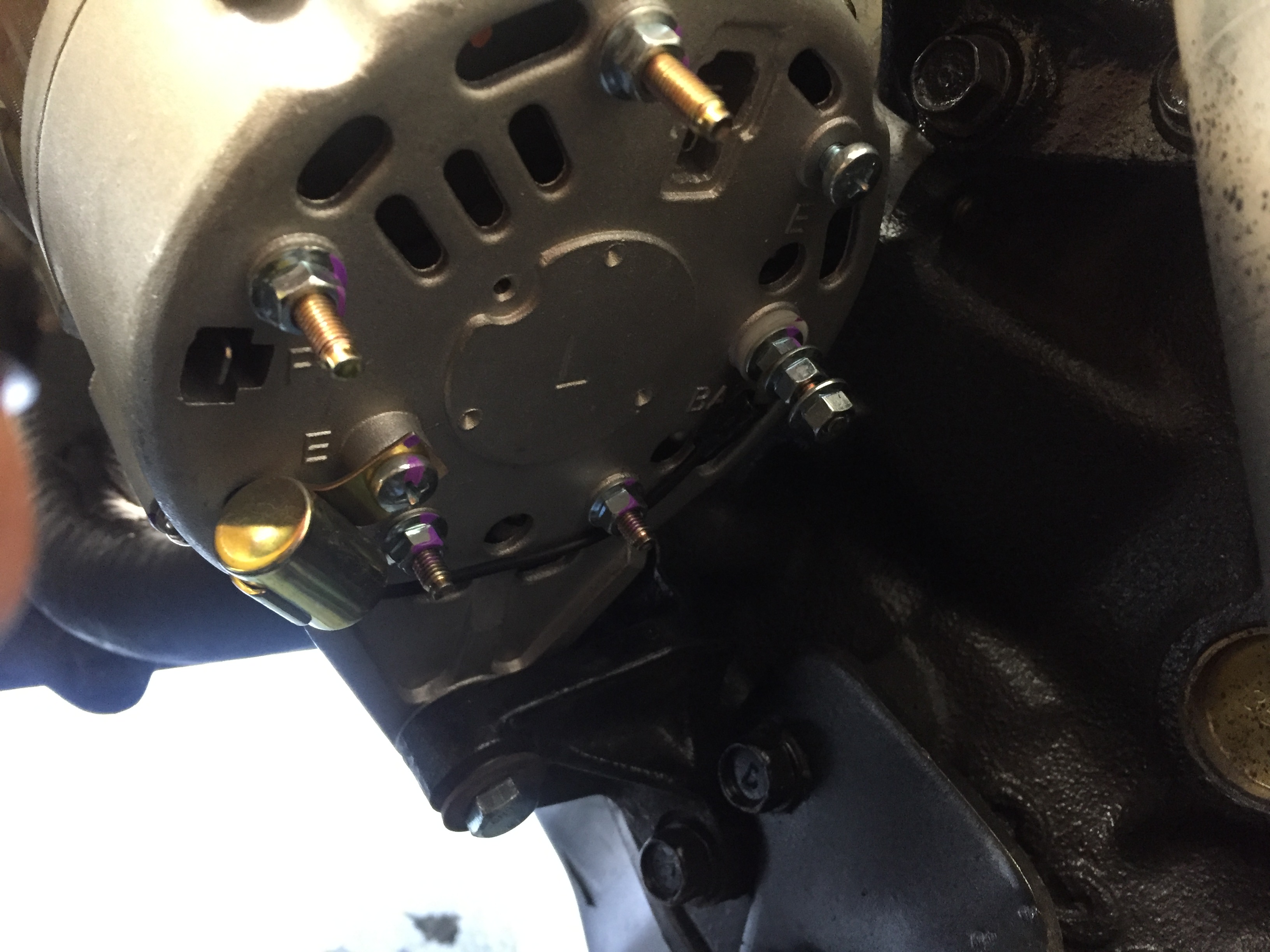

I should have taken a picture of the 60amp alternator before I installed it. Here it is anyway. Connections seem to be straight forward. The VR two wire plug, then 12v and ground. Do you guys agree to what you can see as far as connections. What threw me off is that the condensor is hooked up to where I think the 12V connection should be and the ground goes to the screw that has the Phillips head on it?
There is another single pin connector that shows a "P". Any idea as to what that might be. I'm trying not to mess this up. The new VR comes in tomorrow.
Thanks for the input.

Or the "P" is for 12V and where the condensor is wired is the ground?

I was told BA, which is connected with a condensor is for 12V, the "P" is for the gen idiot light and the E is for ground.
