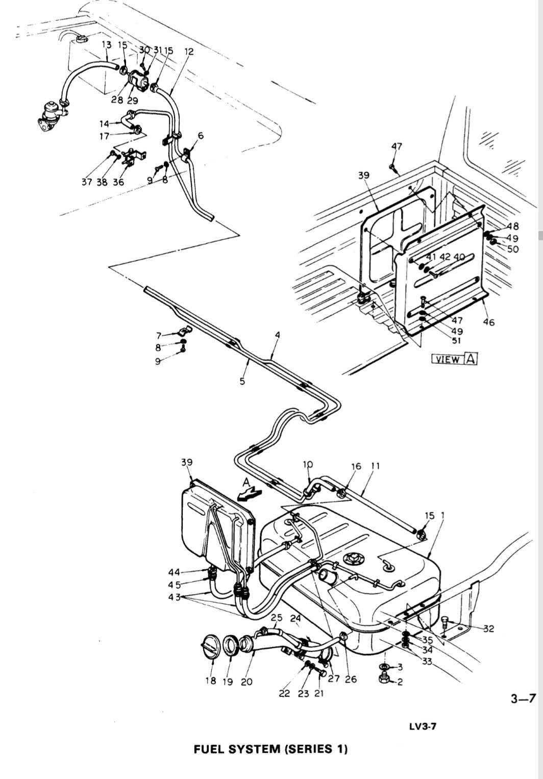

My question is does the 1972 have a return line? The hose that was used for a return line on my truck looks like is was for the fuel ventilation system and went to a check relief valve if I'm looking at the attached graphic correct:
Since I don't have the check valve can I just put a filter on the fuel vent line and oil pan line and just let them vent to open air?

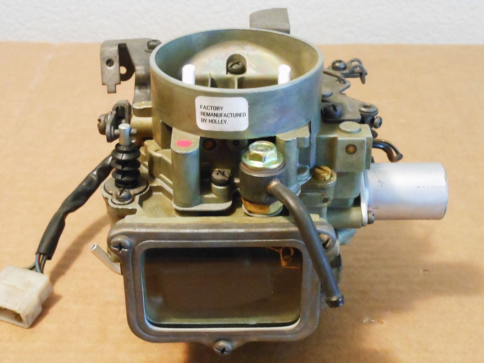

Ok I only see one fuel nipple on the 1972 carb. So does it make sense to put a filter on the fuel vent and oil pan hoses? (don't have the check/relief stuff

Nice work on the research. First I will start with the fuel filler. The small hose is needed to displace the air while filling up. I bet it's slow to fuel now.
The hoses on top going to the plastic bottle are part of the expansion system. Without a vented gas cap you need someplace for the tank to vent while the fuel heats up and expands.
As far as the valve for the oil pan/fuel tank that is where the pressure is released with a non vented cap, with that working you won't smell fuel as it expands.
Since parts are missing I would just put a filter on the oil pan vent and place it up high. If you can find a vented cap then you could plug all of the other lines but you may smell fuel vapors in the area of the vented filler cap.

Thanks for the reply Luvrv8, I'm gonna take your advice and run a line up the side the of engine compartment with a filter for the oil. The filler line is disconnected from the main tank but still connected to the filler neck. So really it's vented at that line just hanging down to open air. I haven't ran the truck long enough to notice any fumes since I garaged it shortly after I got it to fix some brake issues. I'm gonna cap the original vapor line and run with the open filler neck line and see how it goes. I did just come across a post on a forum for a wolverine atv that has an open vent line people complained about fumes, a solution was offered to put a regular fuel filter on the one end of the hose with the other end open. I may try that:
http://www.wolverineforums.com/forum/9- ... pdate.html
Still haven't tried to start since installing my weber I'm waiting on a new fuel pump coming in the mail. I'll post an update when I get it running.
