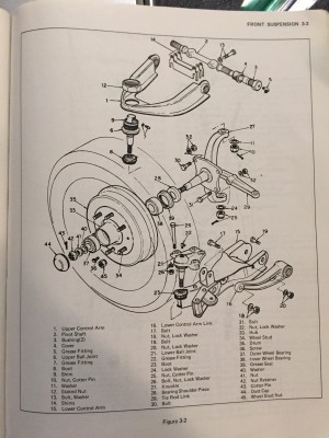

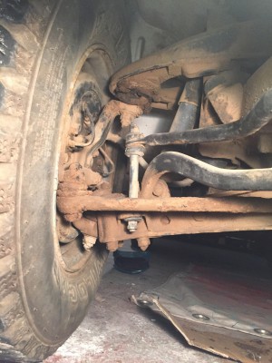

I have the same question - I just got my 72, I have little experience but looking at my front suspension all the bushings are shot and it's caked in grime from sitting for a couple years.
checking out the shop manual and thinking I'd like to replace the upper and lower ball joints. Any other parts that I'd be good to replace?
