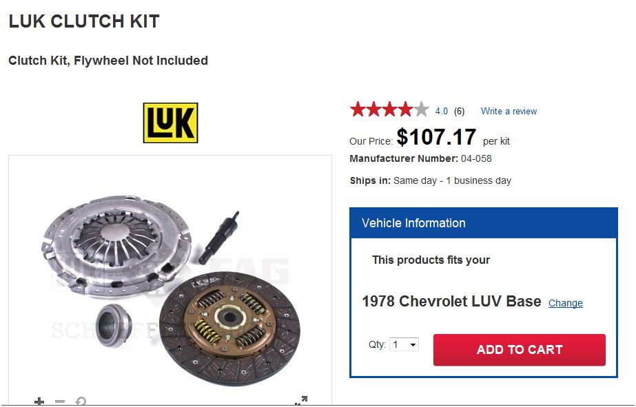

Is this what I need to order? I want to be sure before I place the order. Thanks all for the help!

That's the right part number & LUK is a good brand but you can get the same thing a lot cheaper: rockauto.com will be about $75 shipped with the 5% discount code (B98FFC1C618B8C).
OEM was Exedy, they're about $95 shipped.
