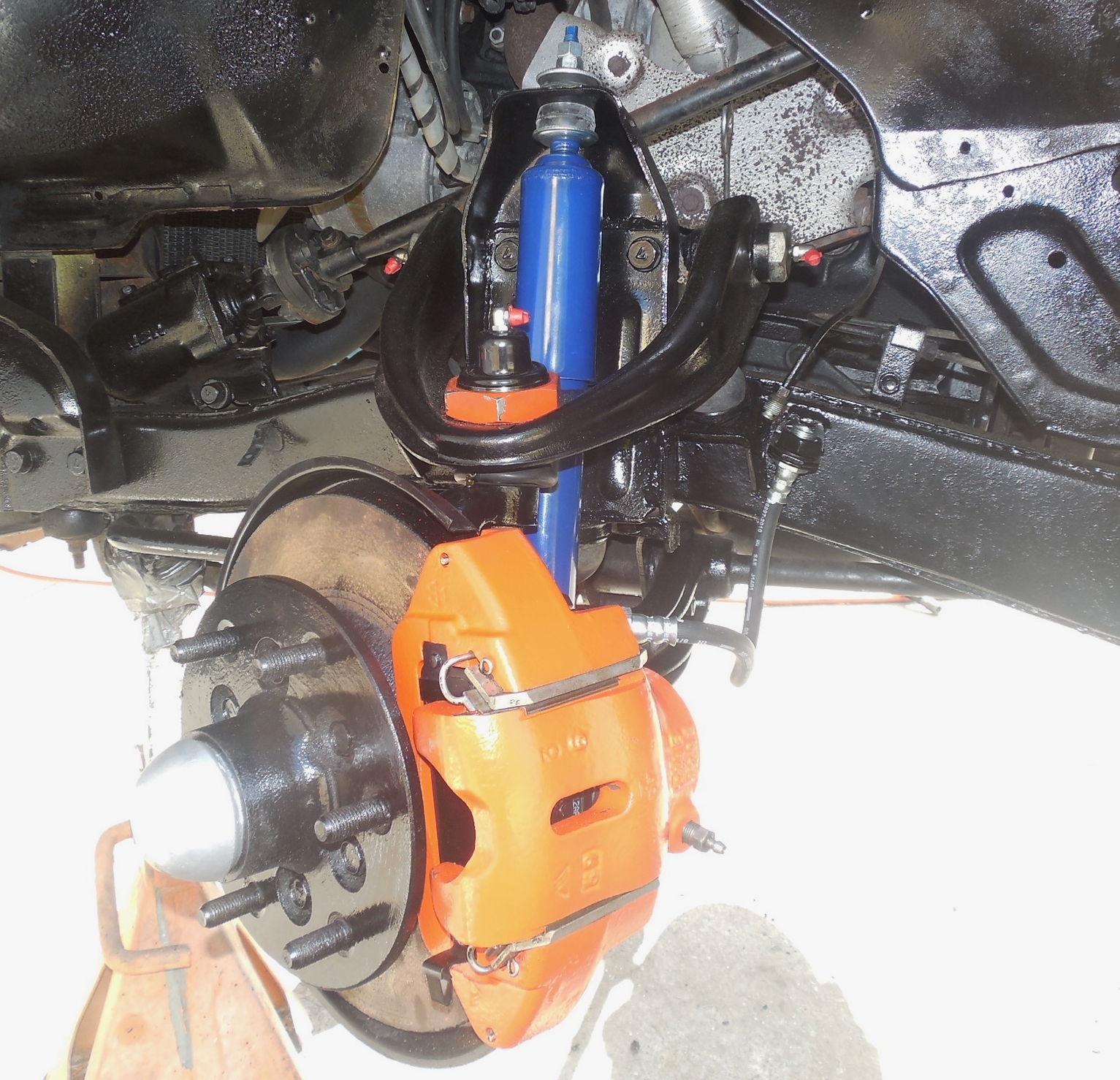

That doesn't sound right .... GOT PICS ? ..Pics help us see what your working with. What year you working on ?
My 77 has a metal line from the master down to the frame then a rubber line to the caliper
...24

My bad, I always forget to say the year info. 1980 Mikado 4x4.
Just seeing your pic, my brake line is different. Mine goes in front of the front "axle" and then goes to a mount on the lower suspension arm. At that point, it connects to a second rubber line, that one runs to the caliper. Of course the napa picture is not correct, anyways it is $84 for their replacement parts per side.
