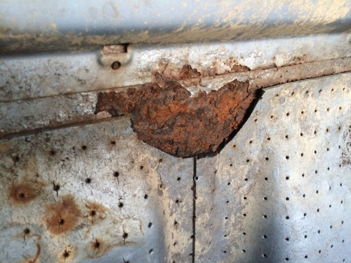

Here are a few pictures of the rust to repair. My first thought was to replace the entire panel, but I may be able to just patch using sheet metal from the donor.
Seems to be all of the way thru. I'll glass bead it and see what we've got. I imagine pinholes and very thin remainder.
Just below the cross cab support.
 Post subject: Re: Luv Cannibal
PostPosted: Mon Nov 21, 2016 1:46 pm
Joined: Mon Nov 14, 2016 11:08 pm
Posts: 35
It may not be to bad if you take small bite I would still brace it.
I have forgot more than most will ever know.
