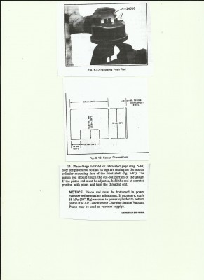

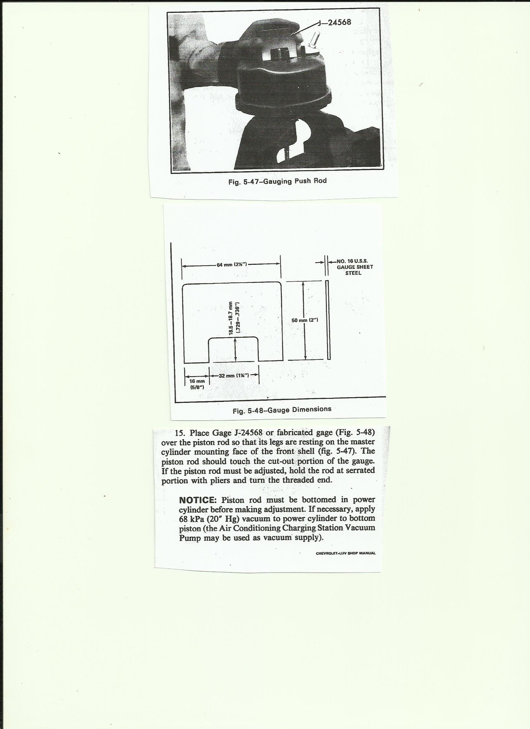

Make sure to set the correct length of the adjustable rod between the booster & MC that regulates the piston travel.
Also make sure to bench bleed the MC prior to install, a piece of steel line 18" long cut in two will allow the open ends to be bent around into the reservoir.

The open ends of the cut brake line put into the filled MC reservoir will allow you to bench bleed the air from the MC by pumping the piston with a screwdriver. This will reduce the amount of bleeding required after the new MC is installed. BTW bleed the brake lines with the engine running, the booster doesn't work properly without engine vacuum.
You'll have to fabricate a measuring device for checking the rod length as detailed in the second image. I used a piece of aluminum flat stock, a piece of thick plastic such as the hang tag from a socket or wrench would work also. I think you could also carefully use a combination square & not have to fab anything.

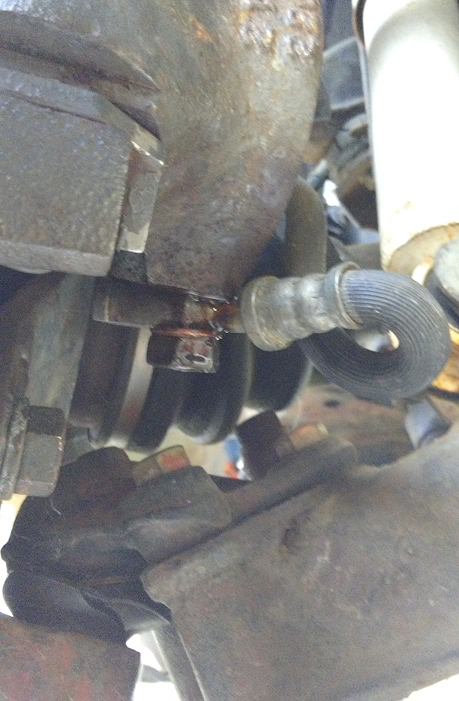

So finally I bench bled my master cylinder, and hooked up my brake lines. As I start to pump the brake pedal to get the fluid going thew the lines, I saw I have a leak where the flexable hose connects to the brake caliper. The Bolt was a little loose, so I tightened it with a ratchet/socket. I wiped down the area, and started pumping the brake again, yet it still leaks in the same spot. The leaks is pretty steady especially when the brake pedal is pressed. I'm not sure what to do next. Maybe replace the copper washer that goes between the connector and caliper. In the picture you can see it's still leaking.

Is there a washer on both sides of the brake hose hole?
PostPosted: Mon Dec 19, 2016 7:52 pm
Posts: 1362
Location: Auburn, CA
I believe there is just 1 (at least that's my current setup). It's between the bolt head and the connector.
PostPosted: Mon Dec 19, 2016 8:22 pm
Should be 2...
PostPosted: Mon Dec 19, 2016 9:21 pm
Great info . My 78 has always had a brake drag . This has me investigating why .
PostPosted: Tue Dec 20, 2016 8:22 pm
mytmouz wrote:
Should be 2...
It will leak if there is not one on each side of the hole on the hose.
PostPosted: Tue Dec 20, 2016 10:27 pm
Posts: 1362
Luvrv8 wrote:
mytmouz wrote:
Should be 2...
Thanks mytmouz and Luvr8. I must have misplaced the extra washer when I had everything apart.
PostPosted: Tue Dec 20, 2016 11:47 pm
At least you found the problem.
