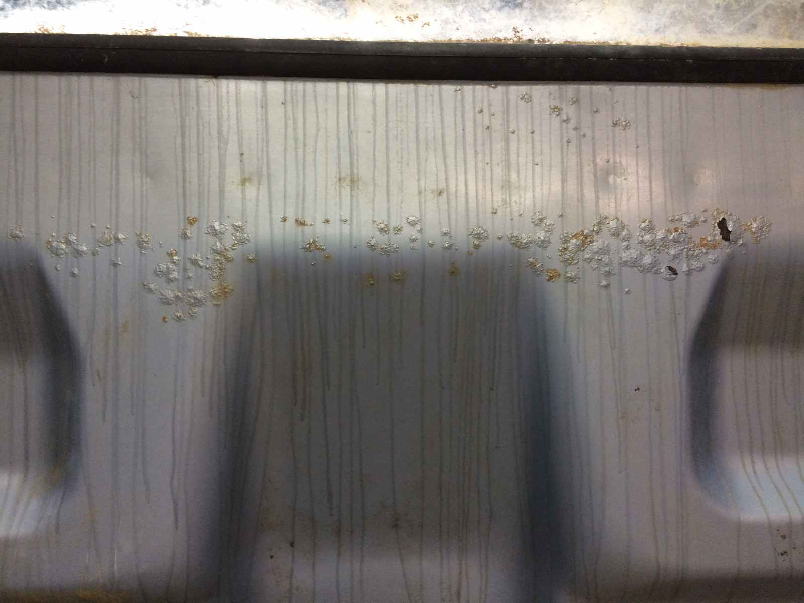

Here are a few pictures of the rust to repair. My first thought was to replace the entire panel, but I may be able to just patch using sheet metal from the donor.
Seems to be all of the way thru. I'll glass bead it and see what we've got. I imagine pinholes and very thin remainder.
Just below the cross cab support.
 Post subject: Re: Luv Cannibal
PostPosted: Mon Nov 21, 2016 1:46 pm
Joined: Mon Nov 14, 2016 11:08 pm
Posts: 35
It may not be to bad if you take small bite I would still brace it.

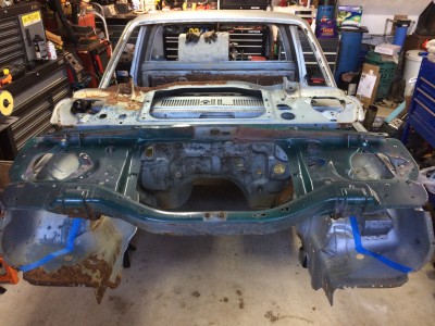

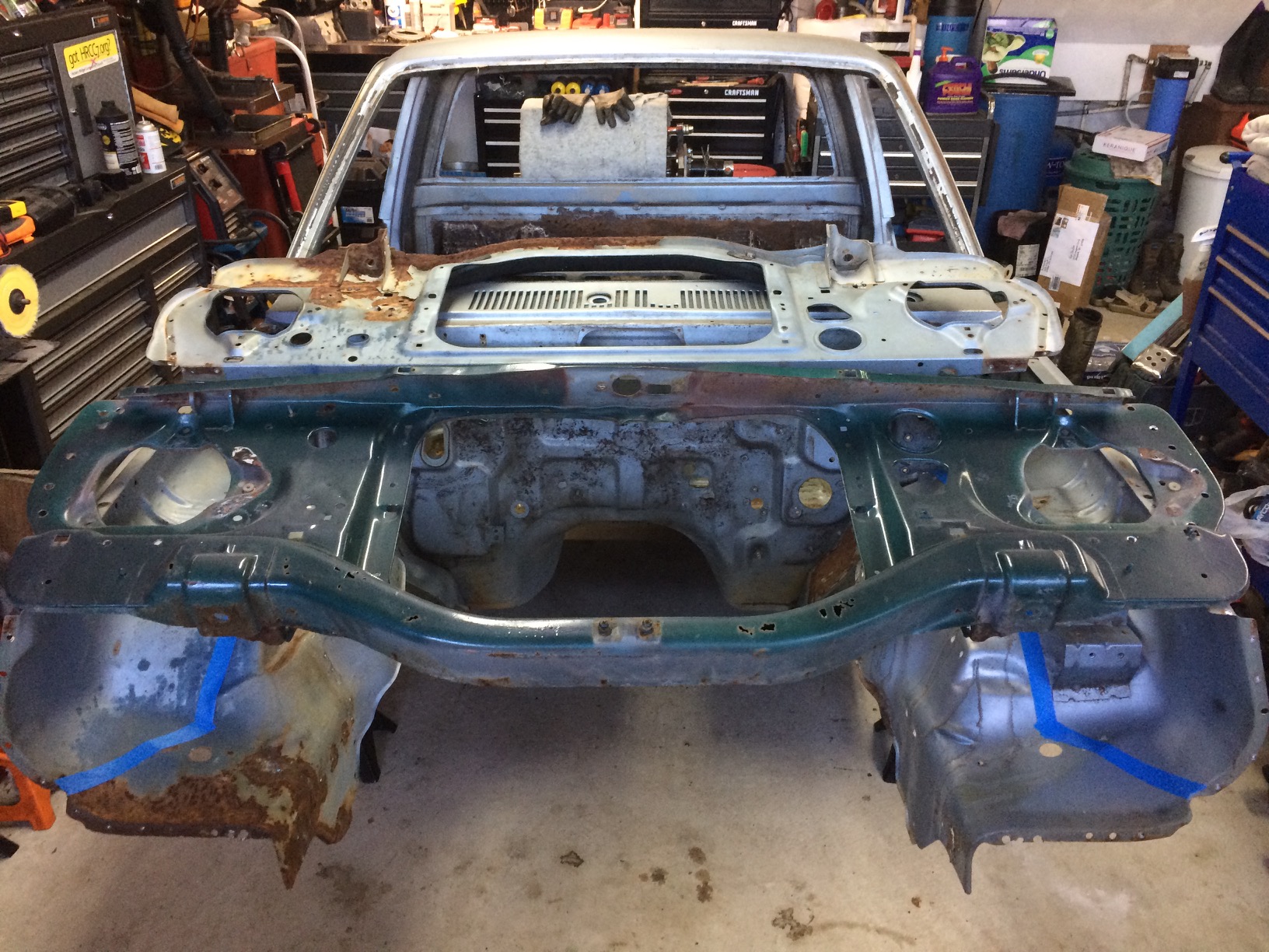

So, got the cab cleaned up to see the extent of rust repair needed. It's not insurmountable just daunting. Fortunately, we have a donner cab.
The radiator support needs attention, we cut the spot welds and removed the support from both trucks. Now it's a matter of making one good support out of the two.
The darker support is from the donner.
PostPosted: Fri Feb 03, 2017 6:55 am
Posts: 360
Location: Texas Gulf coast
I would bolt it to the frame first so you can keep it straight.
PostPosted: Fri Feb 03, 2017 6:23 pm
Posts: 89
Location: Moyock, NC
That was my plan. Didn't figure eyeballing it would work out really well. I've got good pictures for alignment. So, we'll see just how it turns out.
