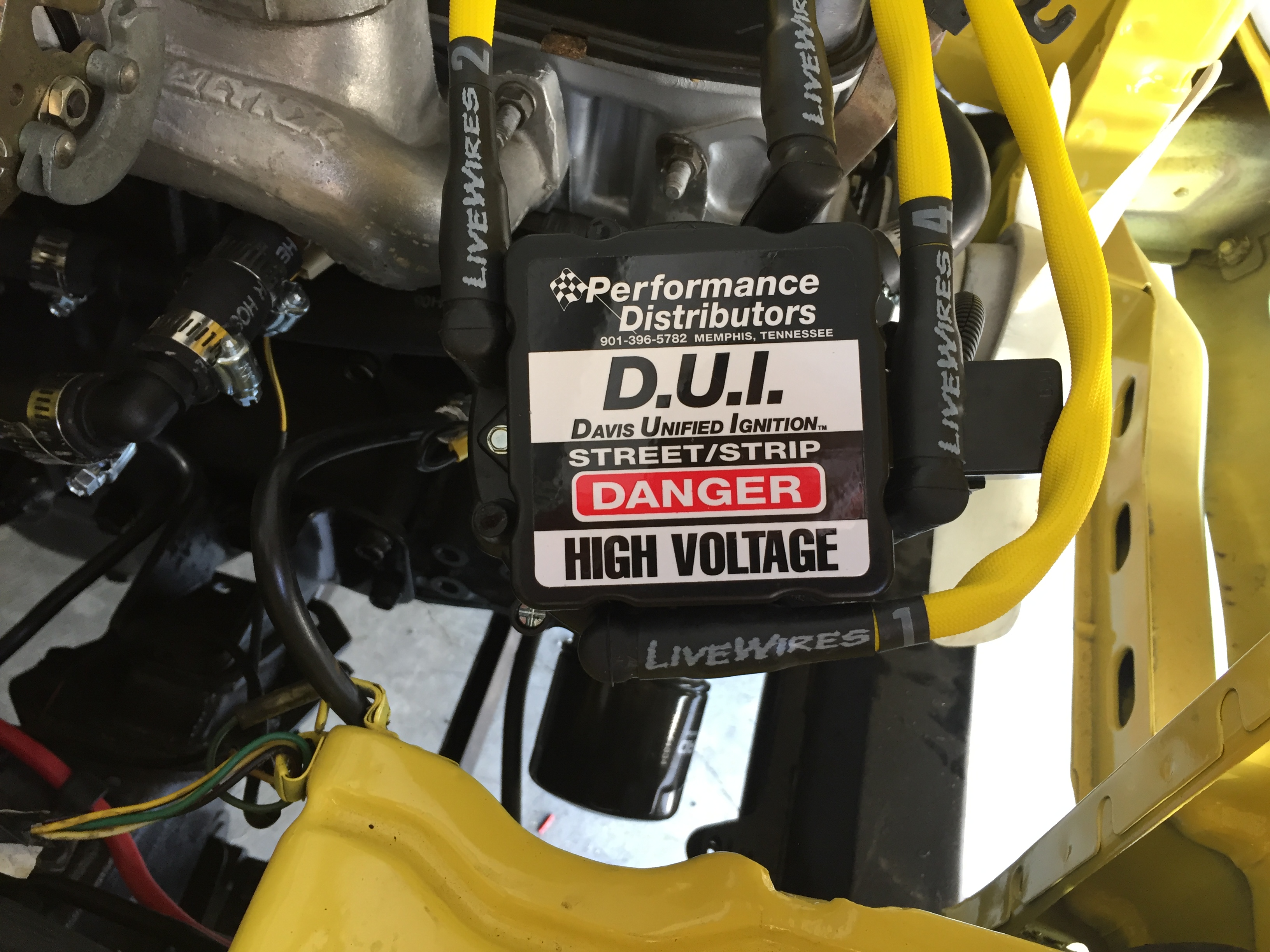

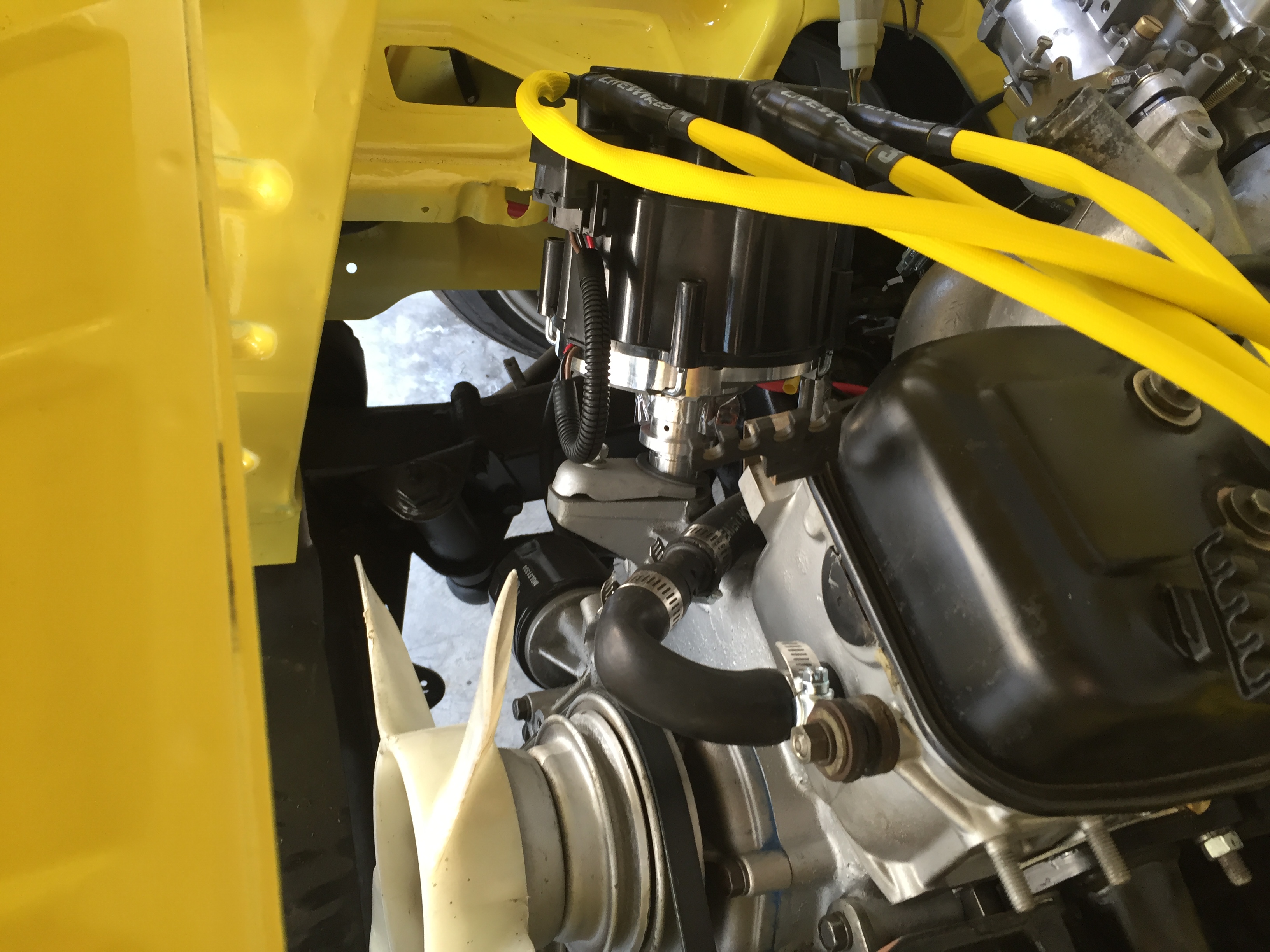

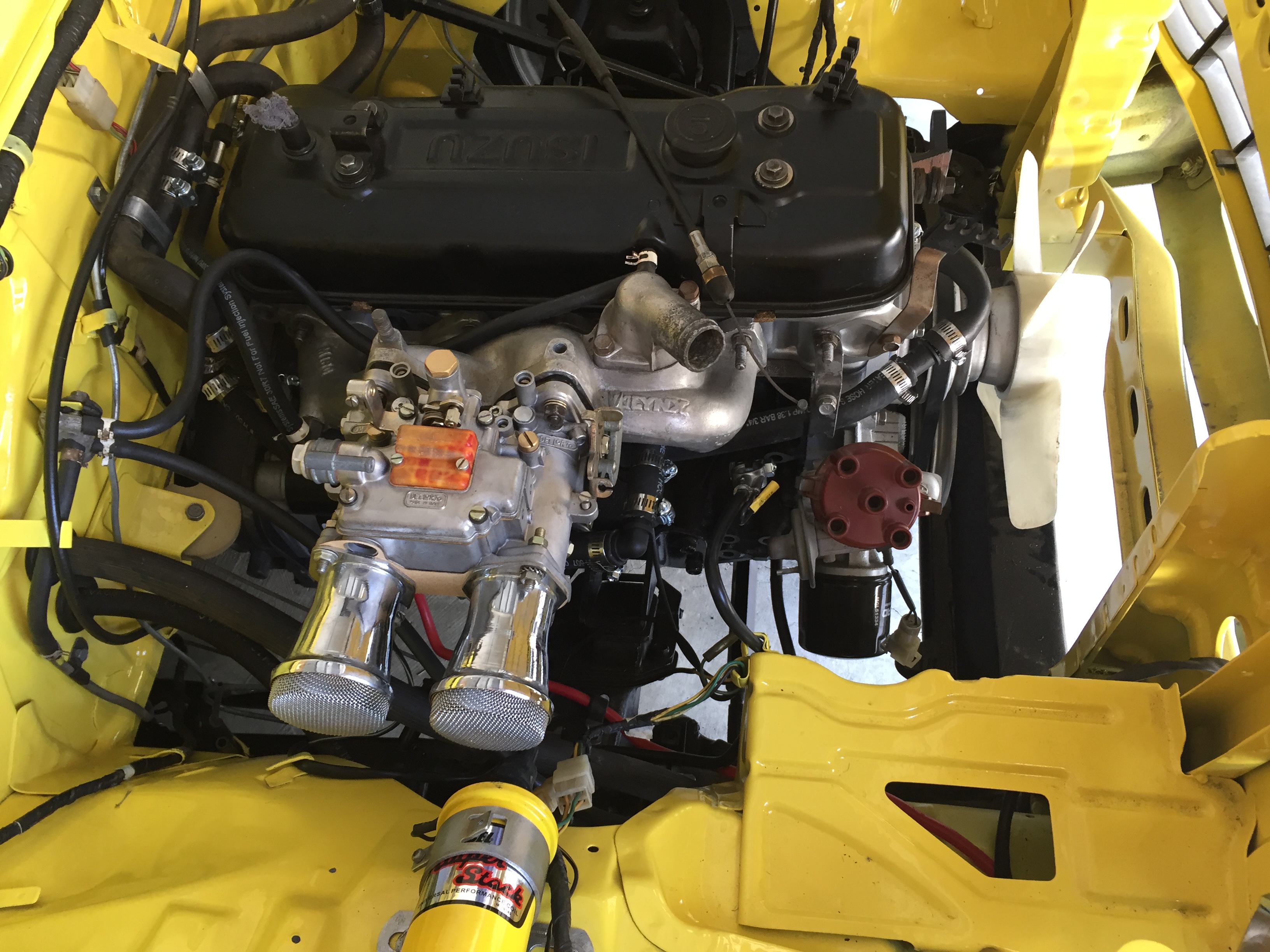

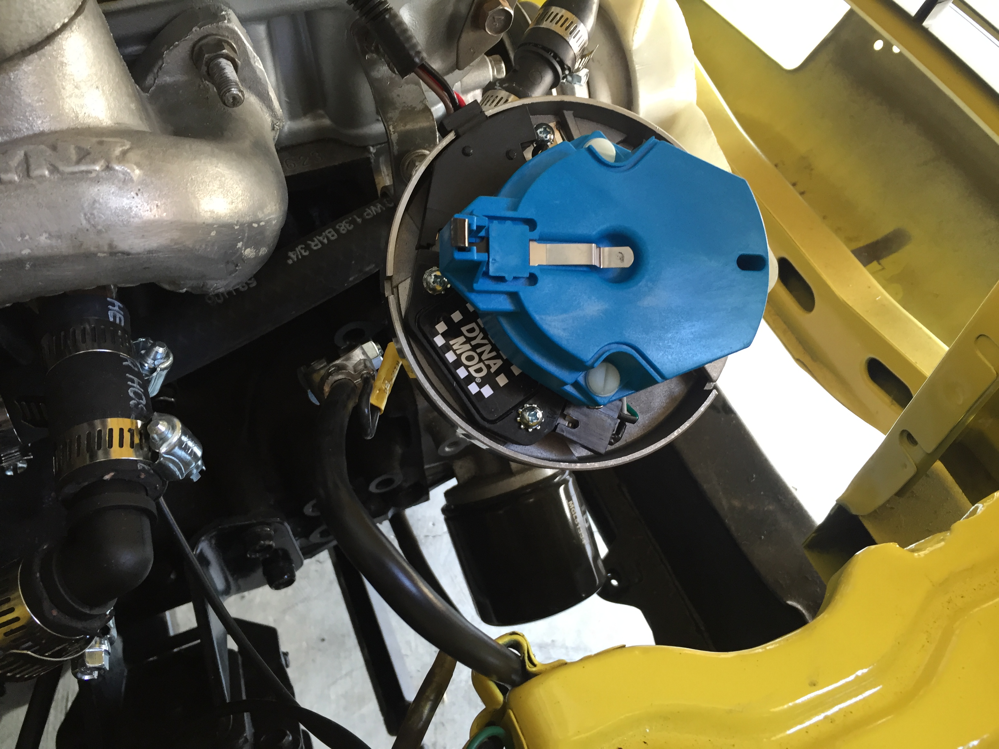

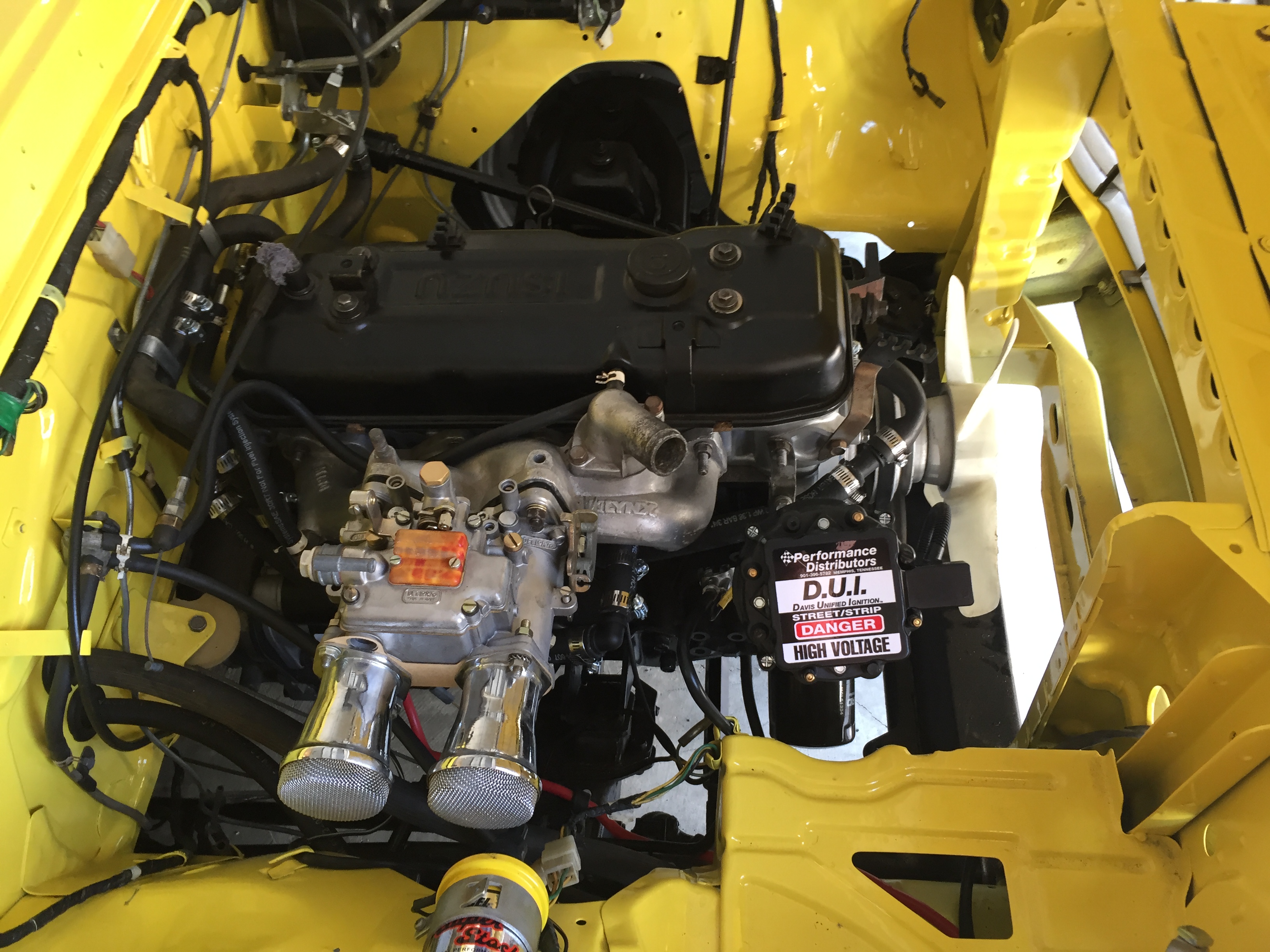

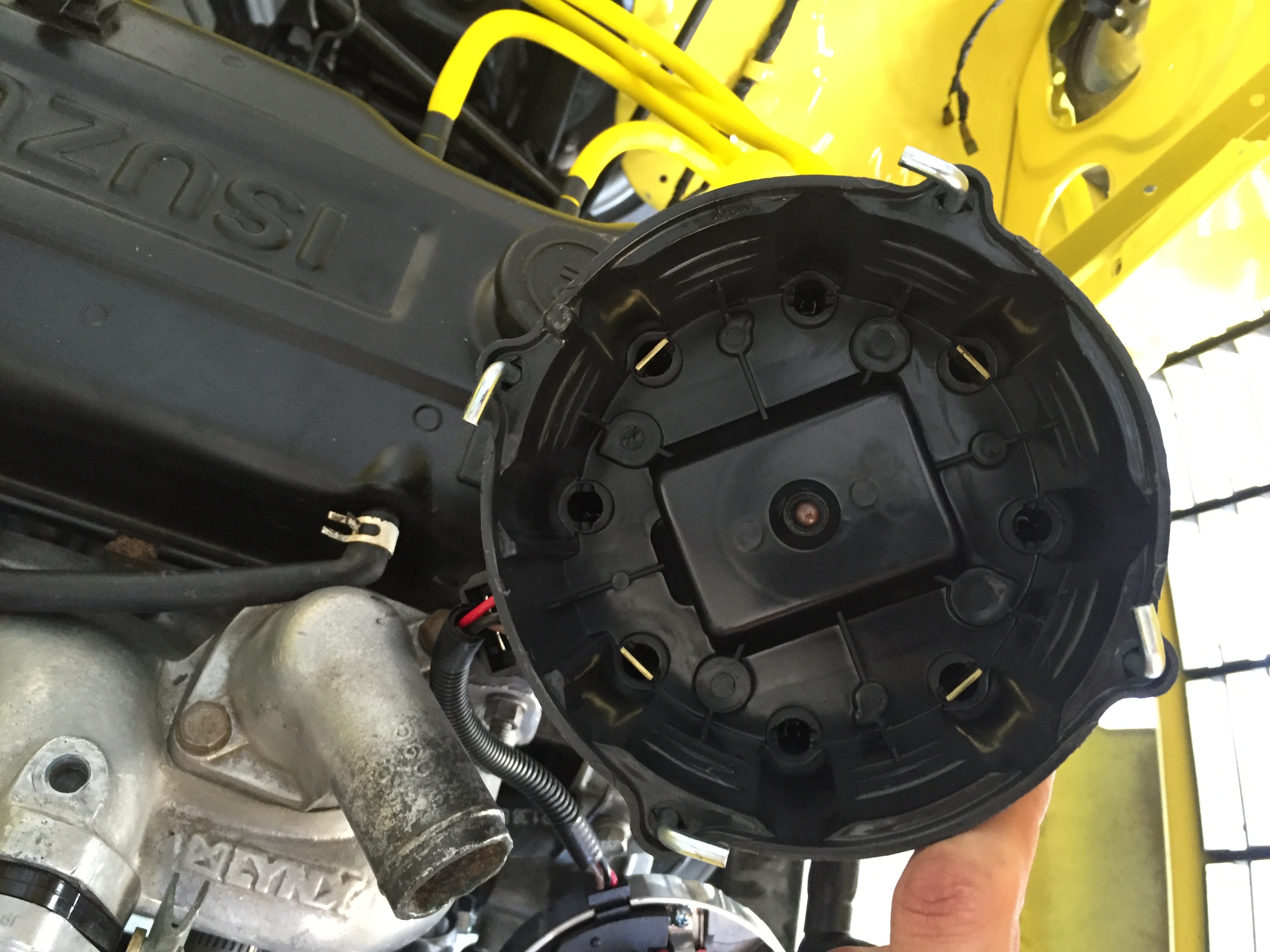

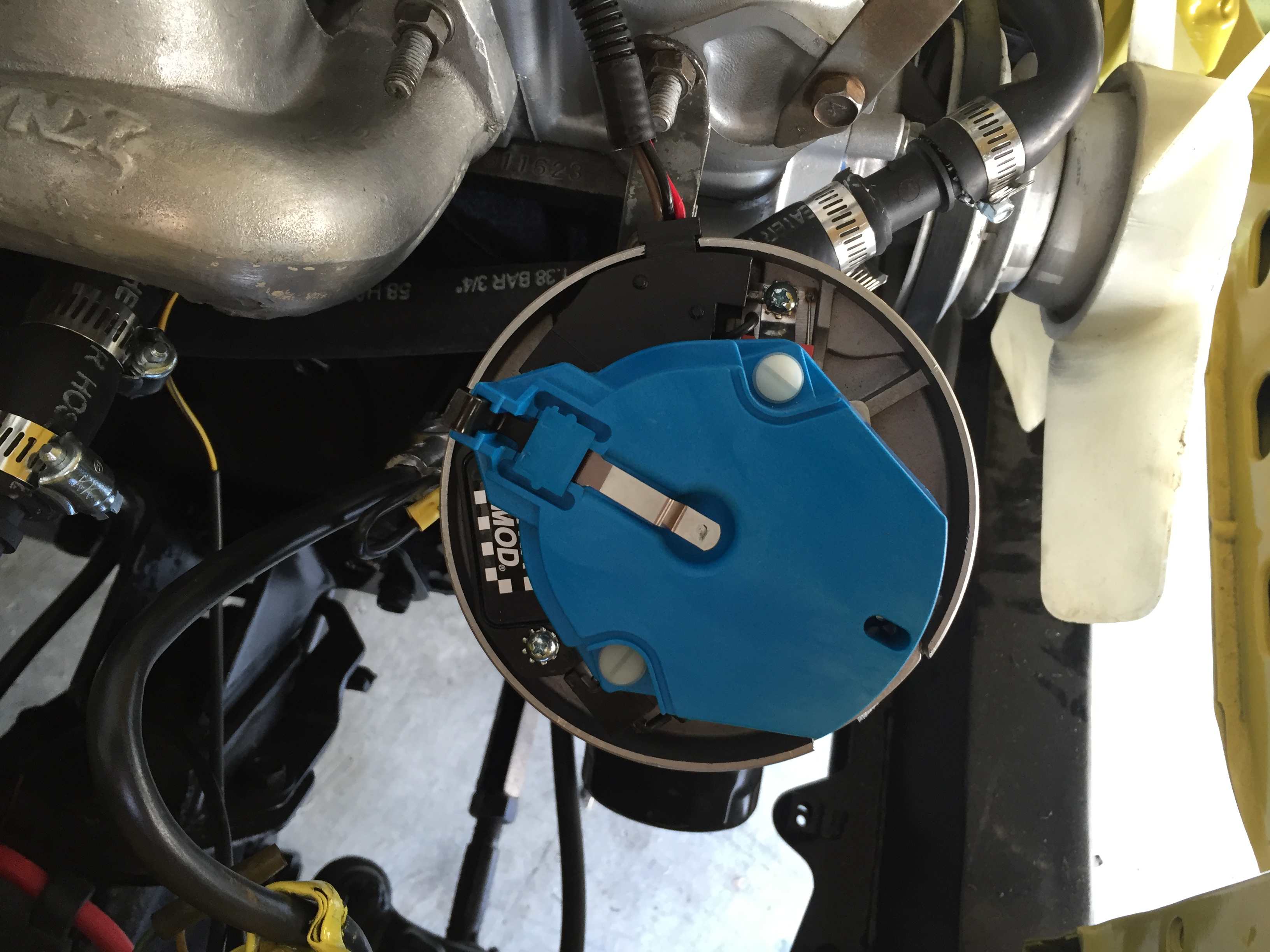

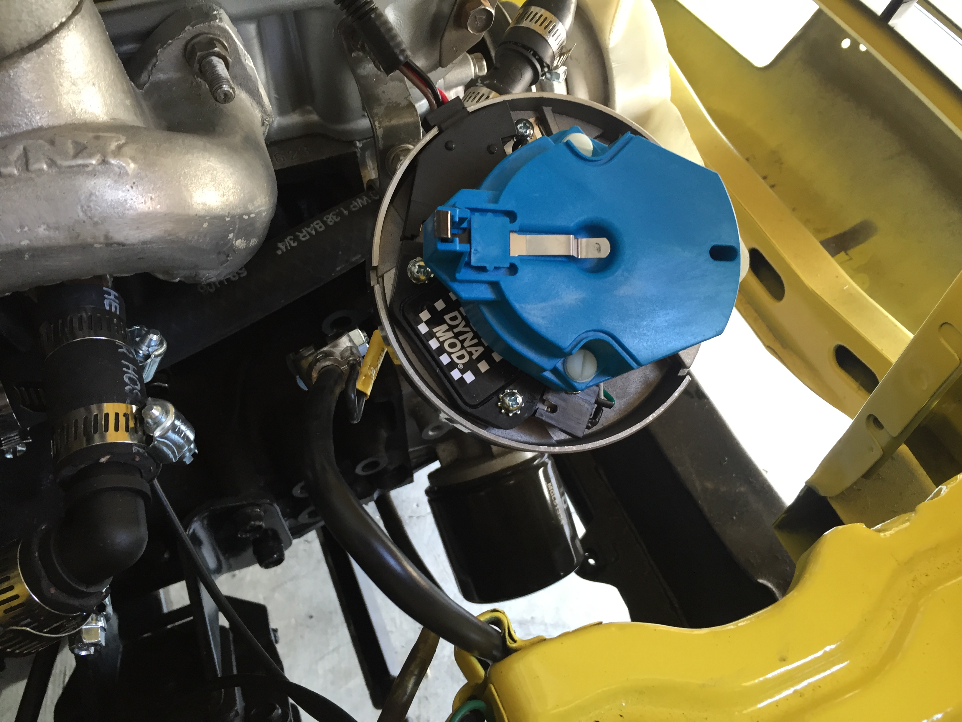

If you have followed my build titled "Attempting to Refurbish Interior", I have a 1978 Chevy Luv that I have been putting back together. I began by refurbishing the interior than got into the engine. Rebuilt and balanced G200 block (.30 over), G180 head, Delta cam w/ dual valve springs and titanium retainers, side draft Lynx intake and carb -dellorto 45, mated to a 5 spd transmission.

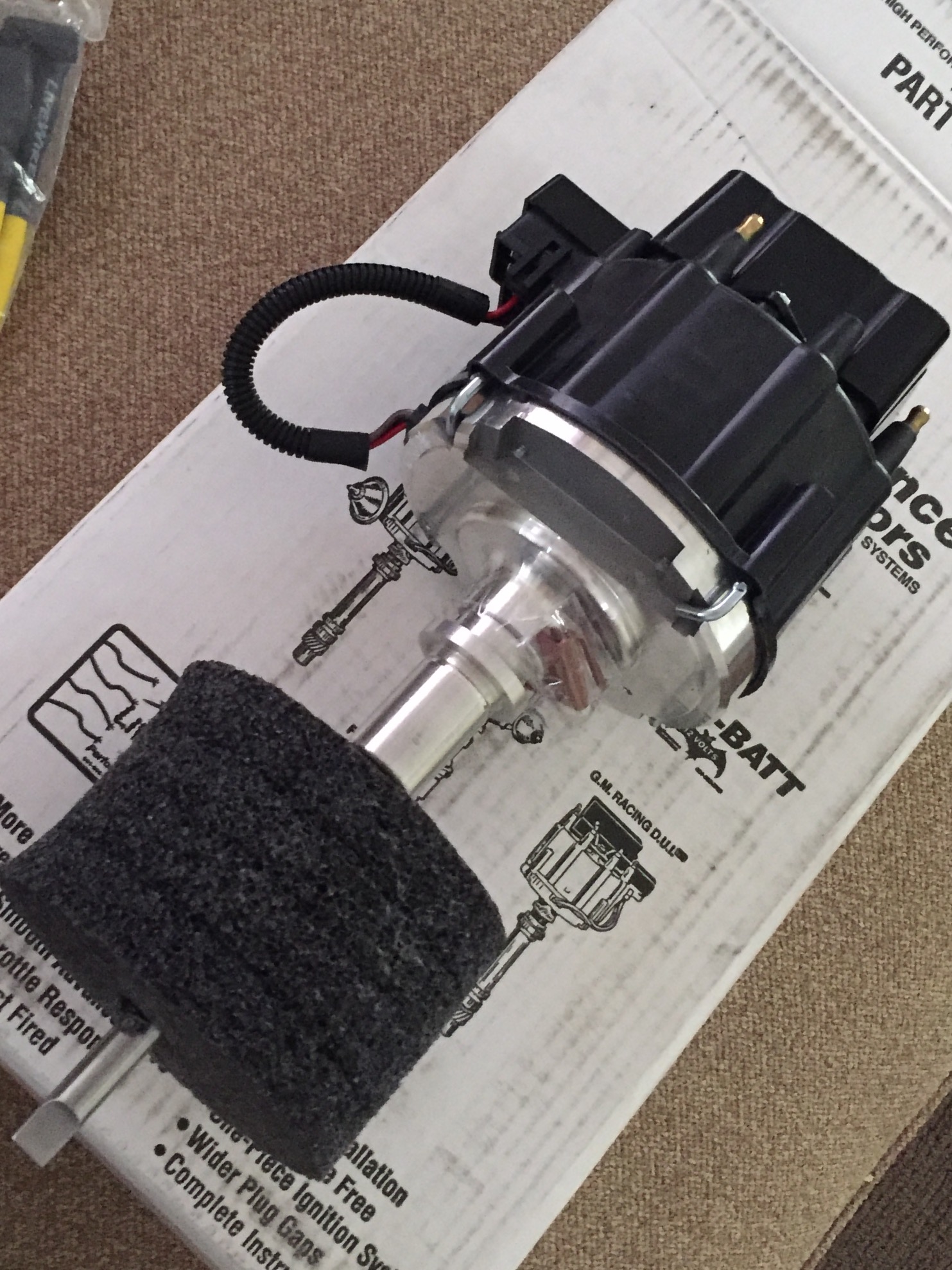

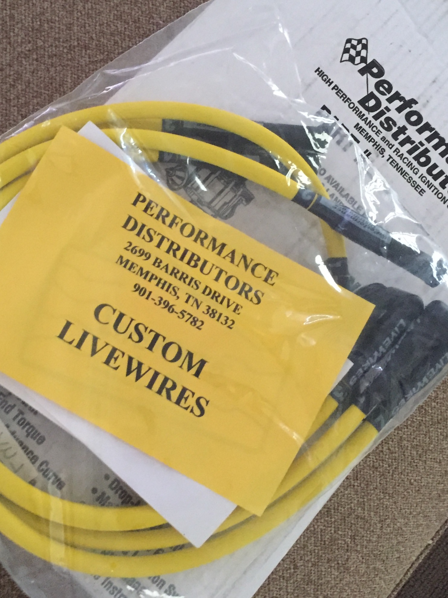

Today I received this brand new complete electronic distributor with a built in coil plus some custom wires made by Performance Distributors located in Memphis Tennessee. This thing is beautiful!! I'll post pictures. I'll have the truck running with this distributor in a couple of weeks.
I talked to Steve from Performance Distributors about them building this and he came through. What a work of art this distributor. Note: I asked them to build it without a vacuum advance and re-curved it for me because of the intake /carburetor set up I am running.
I'm in a hurry right now, I need to get to work. I'll post some pictures up for you guys to see now and when finished, I'll post a video and more photos.

That engine is a piece of artwork. Very nicely done!

Hey, just call the number seen on one of the pictures I took and ask for Steve. The number shown is 901 396 5782 at Performance Distributors in Memphis Tennessee.
