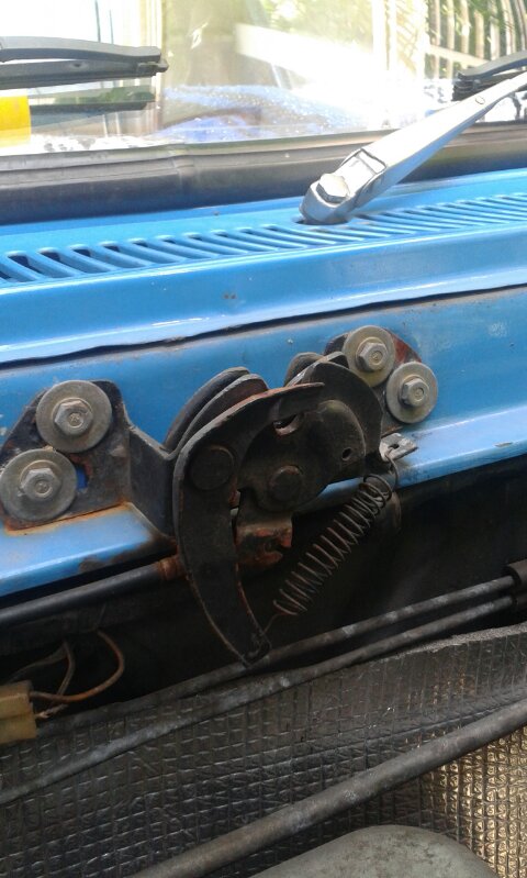

Posts: 607
would the lower one be used for right hand drive vehicles ?
I was thinking of using the bottom cable connection as a back up pull in case my cable breaks.
PostPosted: Fri Jun 10, 2016 11:40 am
Posts: 607
I asked a friend w/ a right hand drive truck to share a pic of his....and sure enough check it out :)

PostPosted: Sun Jun 12, 2016 8:26 am
Posts: 106
Location: Tacoma Washington
So getting an Australian cable setup could give you engine access from either side of the truck.hmmmm
