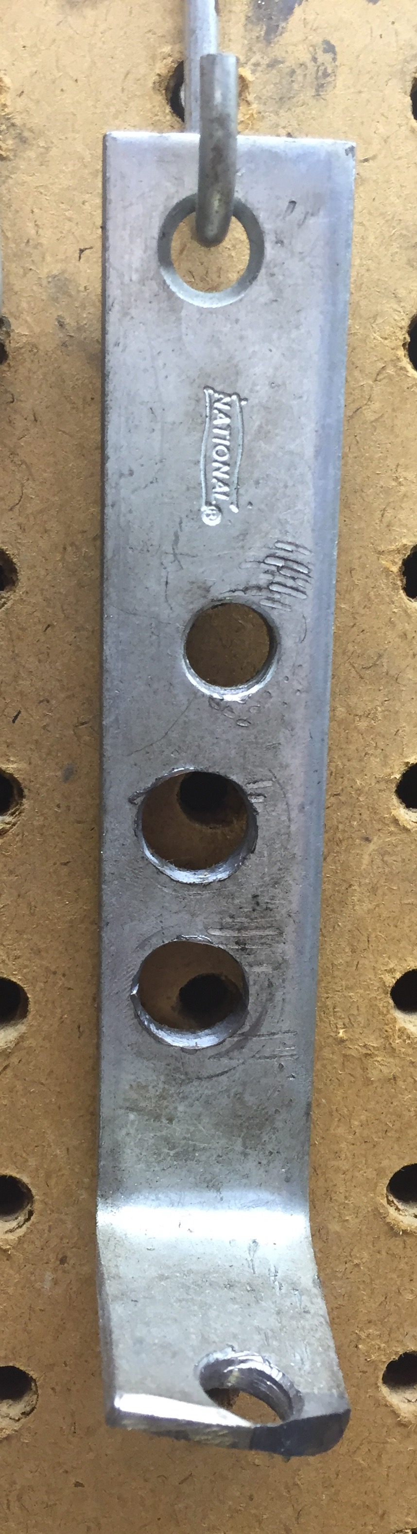

I bent and ground a strong steel L-bracket (from the hardware store) and bolted it into one of the holes in the block where the bell housing would have been, and engaged the bracket into the ring gear.
I later bought a cheap electric impact wrench from Harbor Freight, and that was much easier.

I found the photo of it in use. I flipped it the other way to hold the flywheel when installing it.
