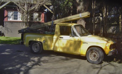

All this talk about gear ratio has me curious to know what mine is.
I have a newer 11k miles Ca stock 1.8 motor & carb w/ smog still hooked up, early 5 spd (rebuilt) trans upgrade & mine seems to scoots down the highway pretty good, when my foot is into it i can reach 100mph 8)... Okay... with a slight down hill :lol: I believe i still have a stock rear end , & running 14 inch tires & my speedometer gauge matches up when i pass by a speed radar sign.
Are there markings on the rear end that confirm what we have or we did we calculate that when it was apart ?

From my earlier reply: "For gasoline powered trucks most manual tranny LUVs & P'ups from '77-'87 came with 4.10 gears." Stock gears in '77 were 4.10s.
