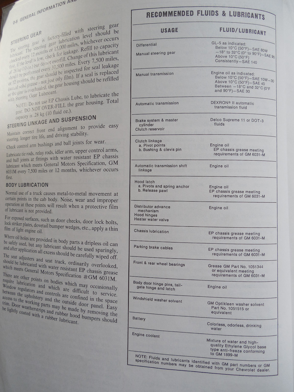

I checked my 1977 series 6 shop manual & it's the 1st section telling you in text but i don't see a chart pointing out where to lube.

That is what i have found myself. There is also an eBay link for a page that is being sold but the detail refers to a 1973 as I recall and that is not clear enough to see the points. My concern is that the least time my Luv was lubed it quickly became apparent they missed some because the truck started squeaking from lack of grease. The eBay reference states there are 15 points for the 1973 so maybe I ought to go in and state they need to find all 15.
