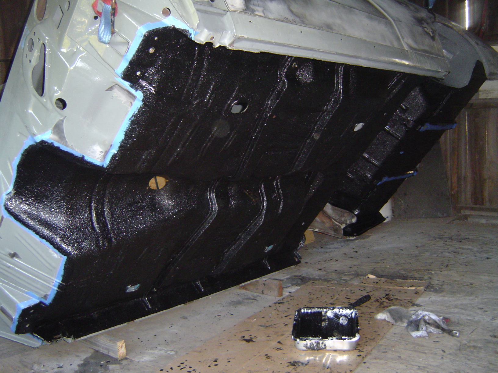

PostPosted: Thu Jan 28, 2016 12:12 pm
Posts: 607
SkyyPayne wrote:
Bedliner would be sick in my cab... Was it a spray can?
I have used Herculiner roll on bed liner after floor panel repairs on my 66 chevelle.
you can spray it if you thin it down but i wanted it on thick and wasn't chancing clogs in a new gun i would have to buy
It was a little messy that comes w/ working on vehicles has worked well looks good it its textured
