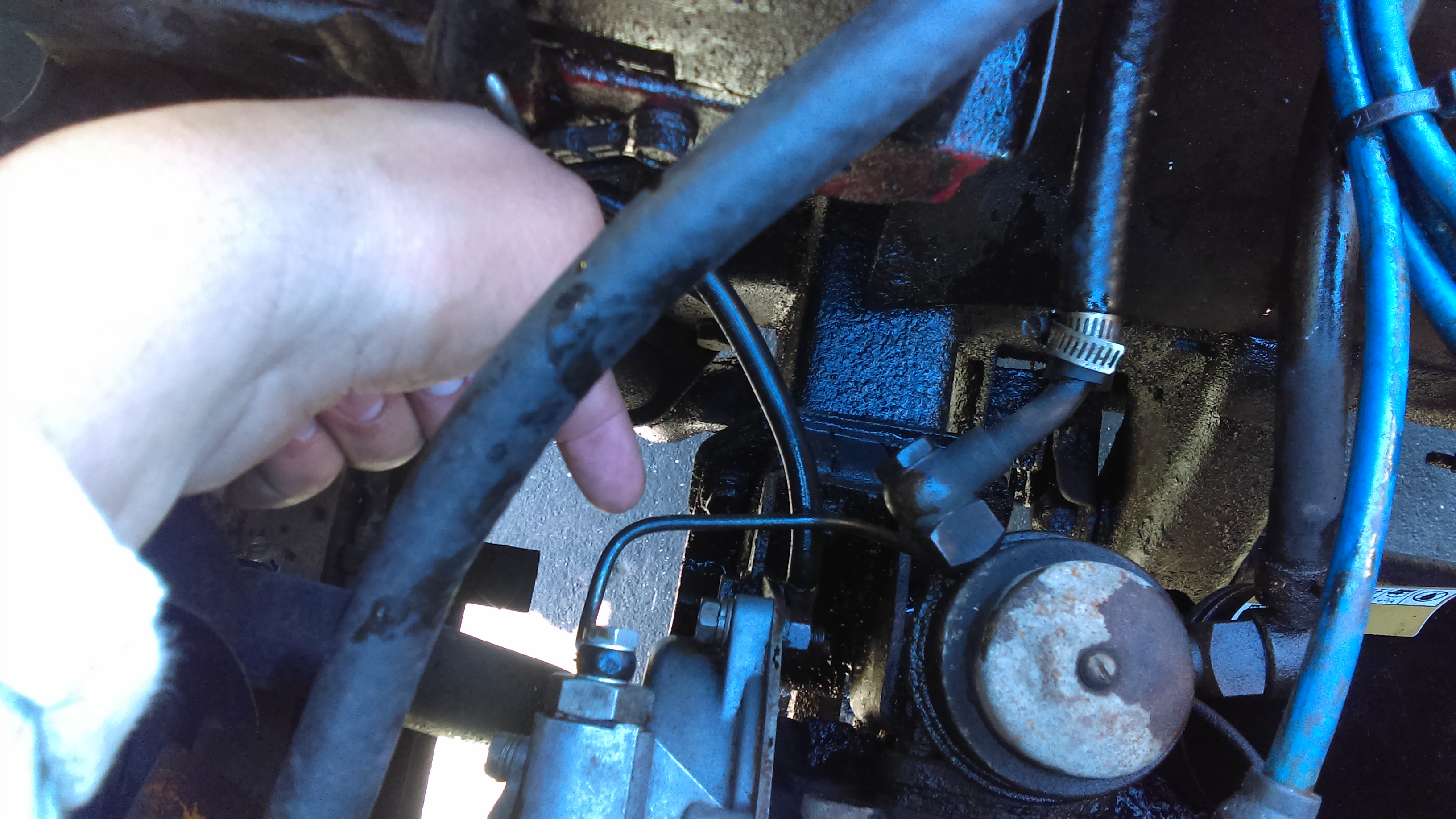

So I have a major problem now with this truck. I must of hit the steel line that goes from the bottom of the oil filter to to side of the timing chain. Where can I find one it's the one with the banjo fittings.
Weld it or try to find a hydraulic shop in your town, they might be able to make one.

Luvrv8 wrote:
I fixed that problem already. I got the line from the 73 the on here is parting out. I went to a hydraulic shop here by my work and they didn't even go down on that size yet alone in metric

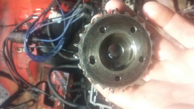

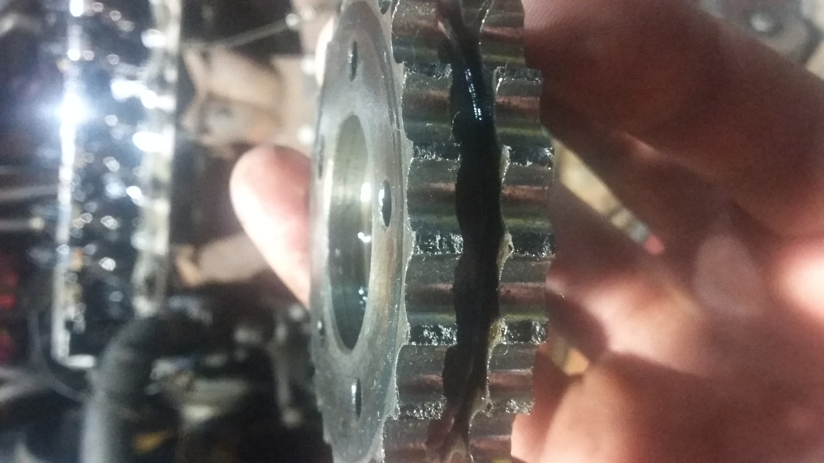

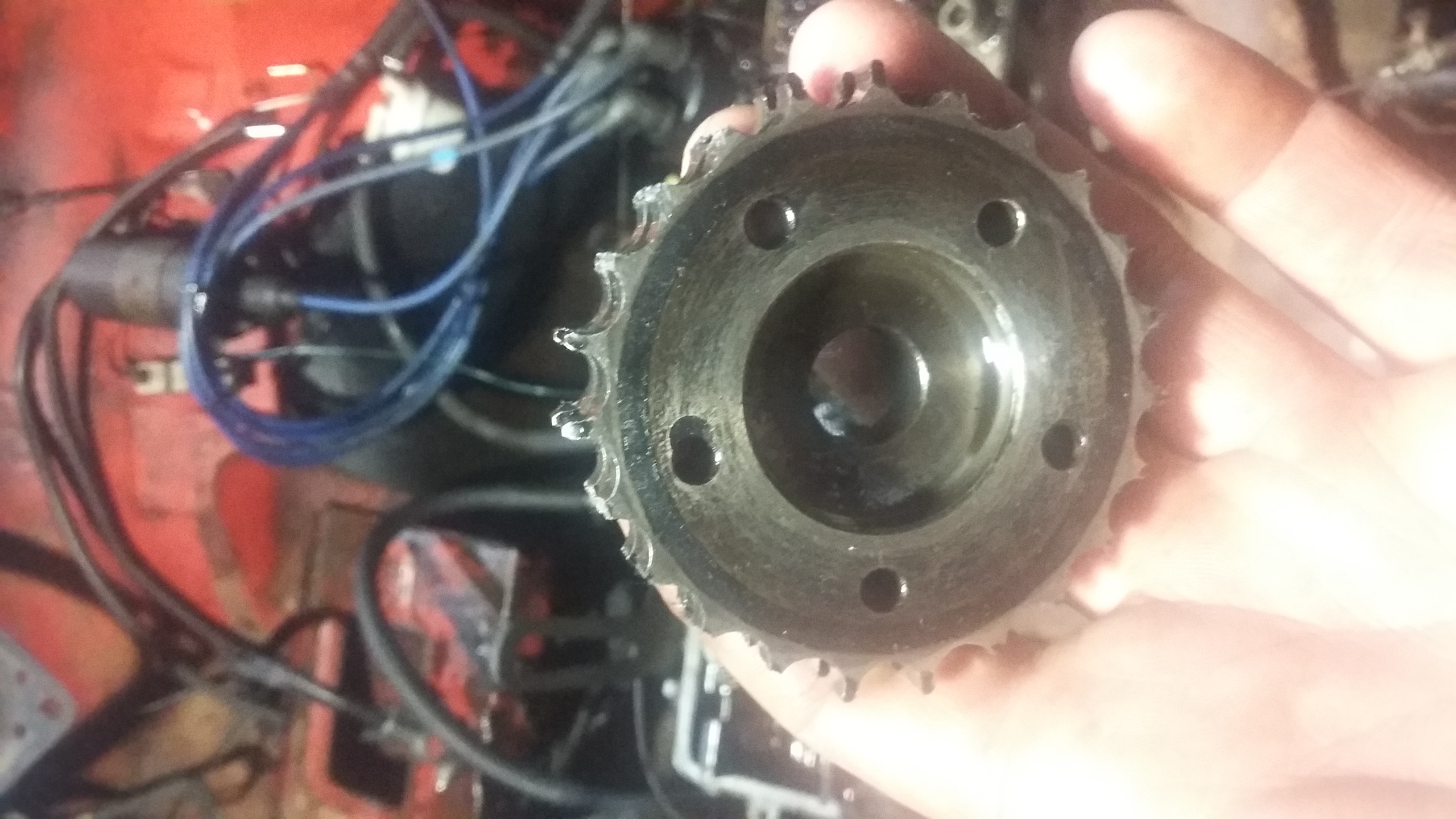

Looks pretty bad all but 6 teeth are broken. I wounder what could of caused this to happen

Bummer

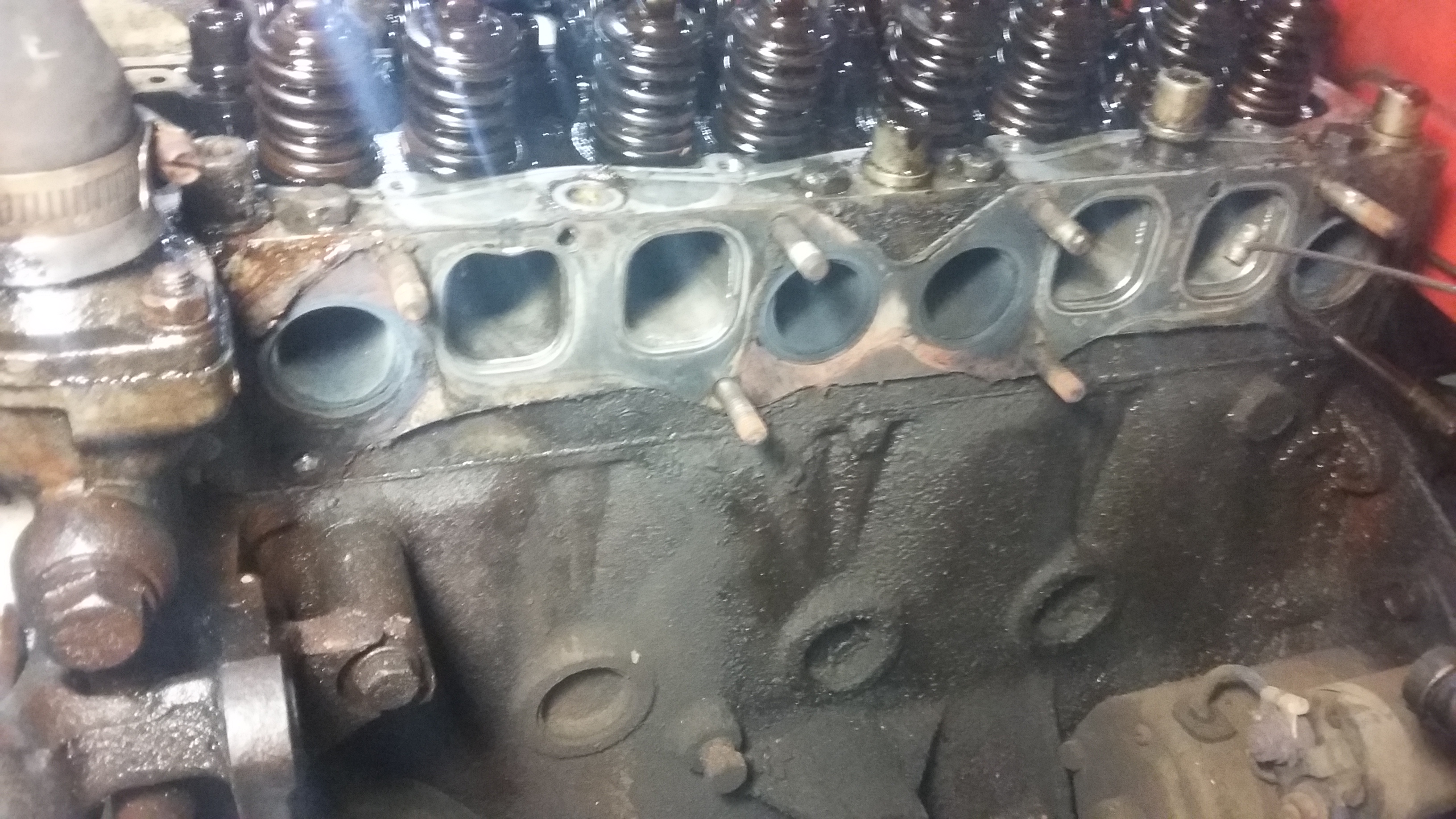

The ports are good and dry, that's a good sing.
