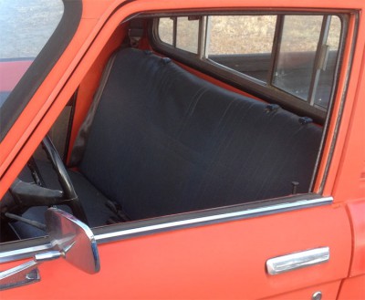

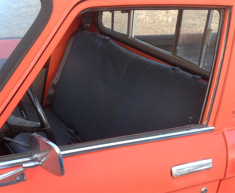

I used a seat out of a mid to late 70's Courier pickup. It fits but tight on the sides.

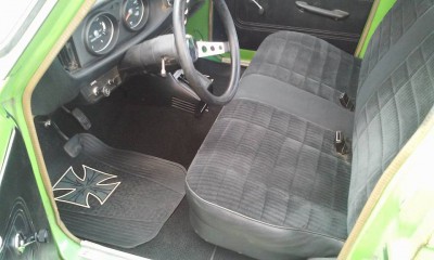

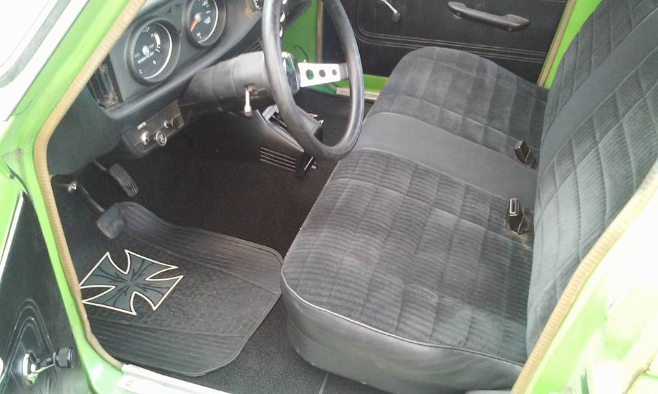

it had a Toyota seat when I got it.
Courier
Toyota

Well I doubt if I'll stumble across a Courier seat :lol:
The Toyota seat looks like it fit good, is that like a 79-85 era seat or an older one?

I got lucky at the junk yard with the Courier seat for sure. I think that is the year range of the Toyota seat but I do not know for sure, it was there when I bought the truck last year.

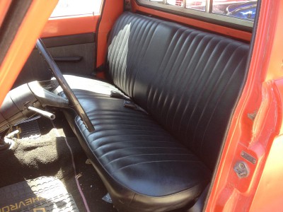

I got one out of an 85 S-10 extended cab.
Had to drill new hole to mount it,but it's a perfect fit.

Hey Ripper86 that does look good in there, thanks!
