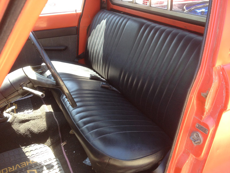

I got one out of an 85 S-10 extended cab.
Had to drill new hole to mount it,but it's a perfect fit.

Hey Ripper86 that does look good in there, thanks!
