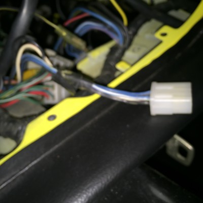

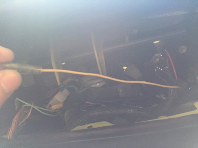

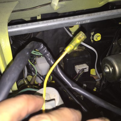

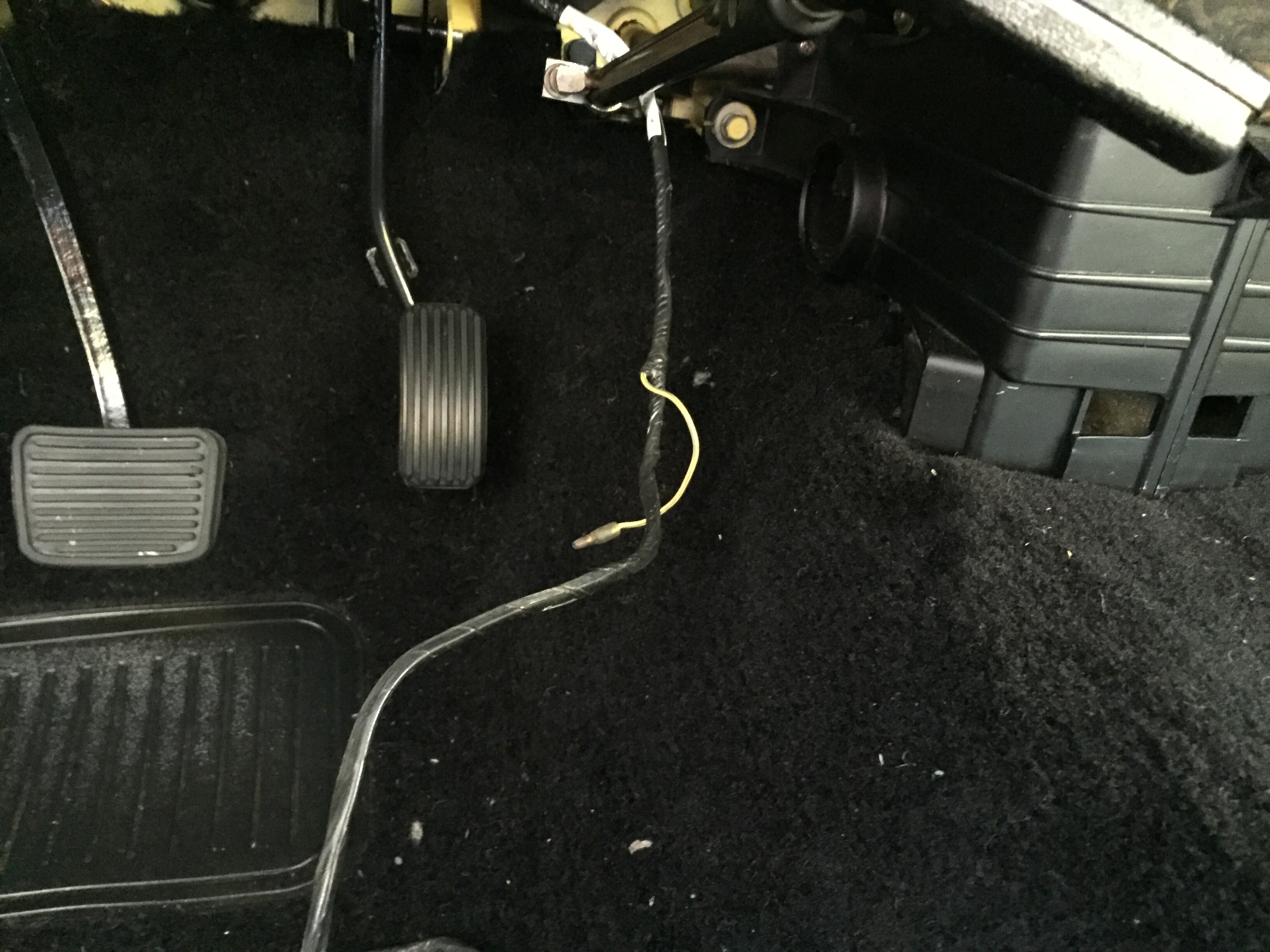

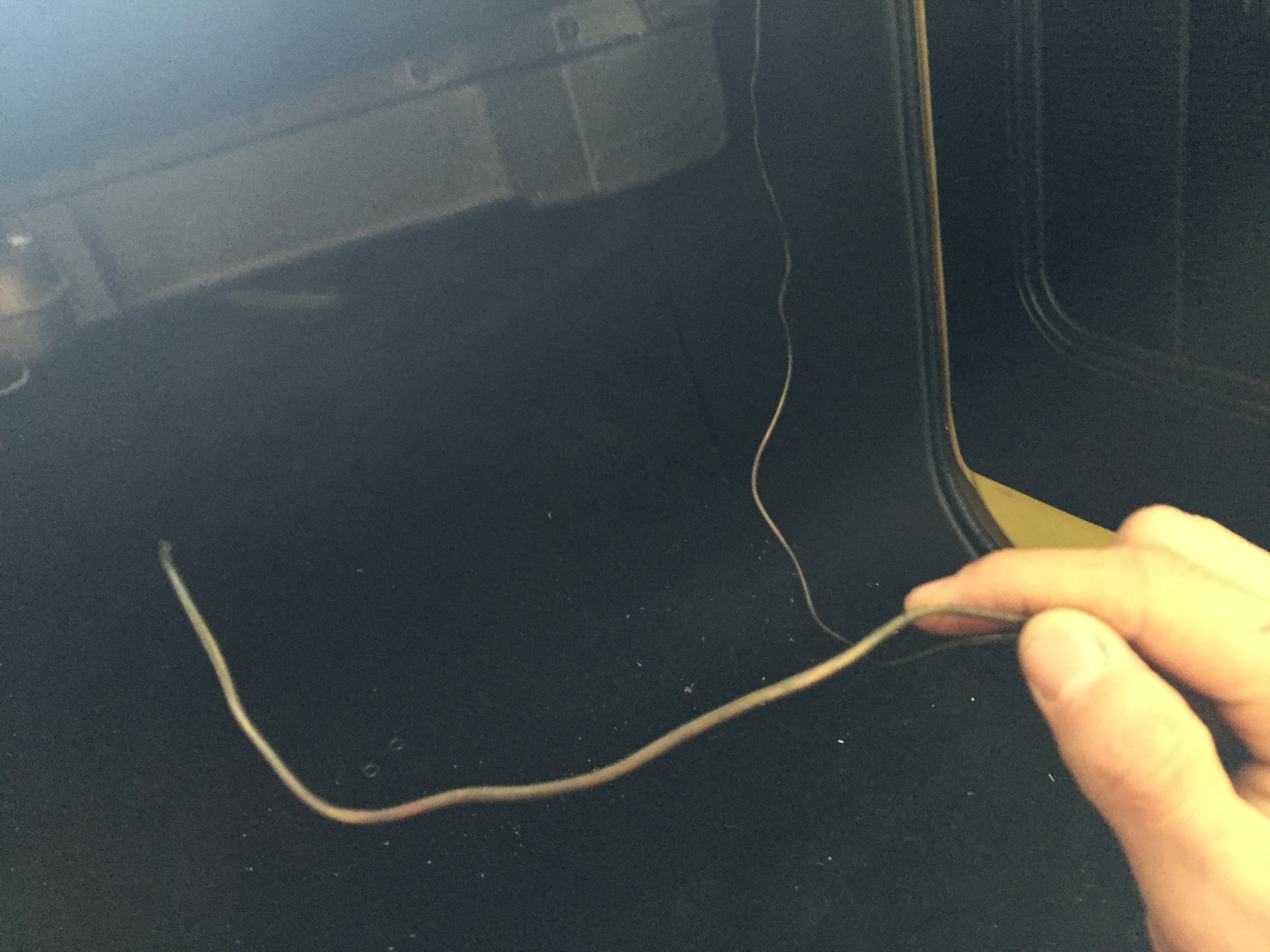

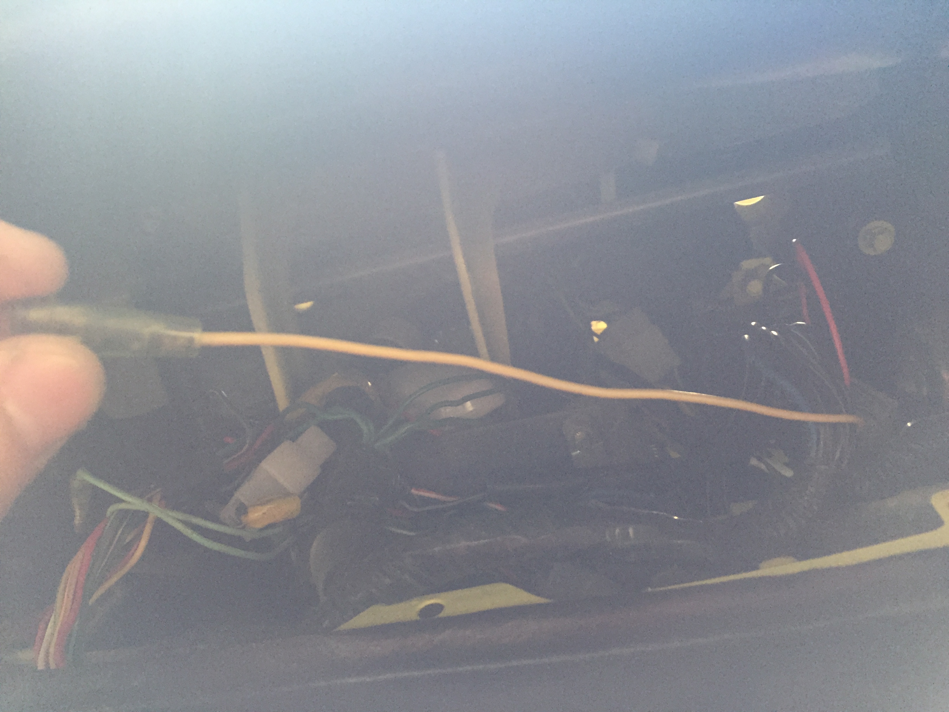

I'll post some pics up to see if you guys can help me wiring some things back. I took this apart years ago and didn't take enough pictures before taking things apart. Any help would be appreciated.
I have the work I'm doing to it on another thread, stock trucks, "Attempting to refurbish interior"
viewtopic.php?f=5&t=29607
In the first pic where does that yellow wire w/ the green stripe connect to? It's on the harness that attaches to the seatbelt.
The solid yellow wire coming out of the gauge area, ?????
The two black wires with white stripes that I have coming out of the gauges area?
The blue wire I show coming out of the ash tray with the four different wires/ connector coming from the harness?
The blue wire coming out from the bottom of the AC box? There are also three male connectors there, what wires go there?
The solid wire coming out of the top of the AC unit, where do I attach that to?

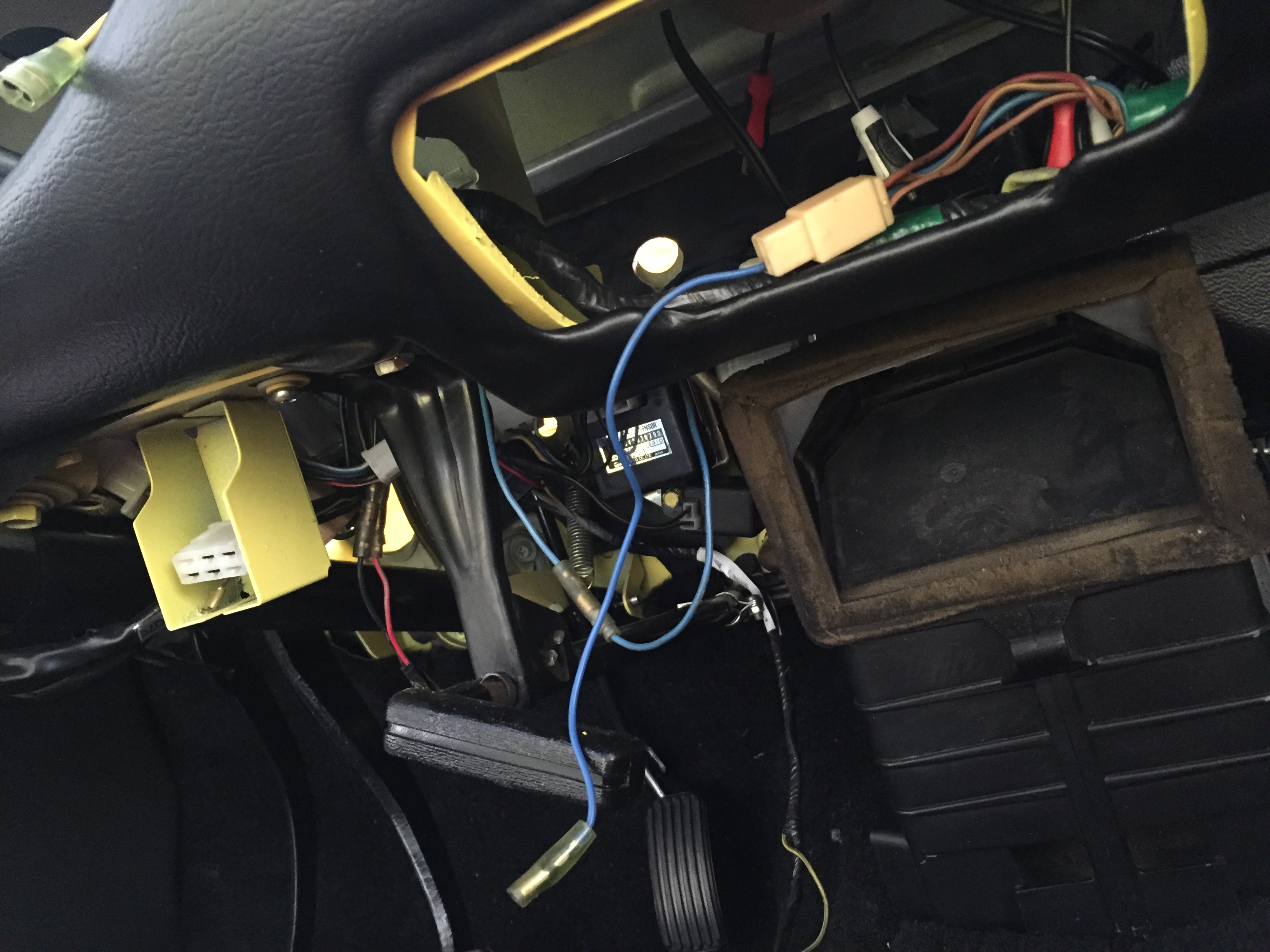

Pic
PostPosted: Sat Jan 02, 2016 1:48 pm
Posts: 607
I believe the blue one is for the radio
I don't recall what yr you have but here's the wiring diagram page for all yrs & more info
http://www.luvtruck.com/Information.htm

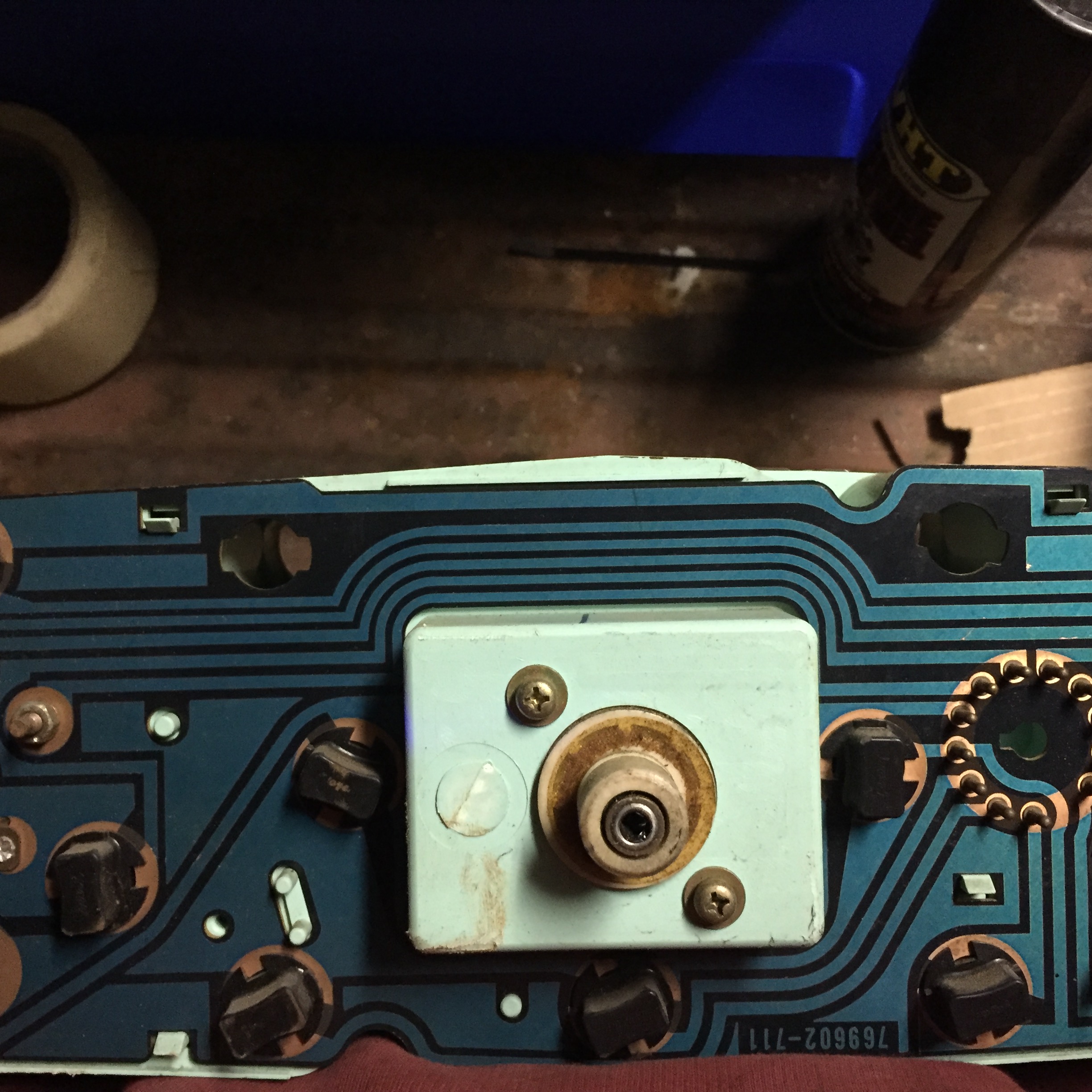

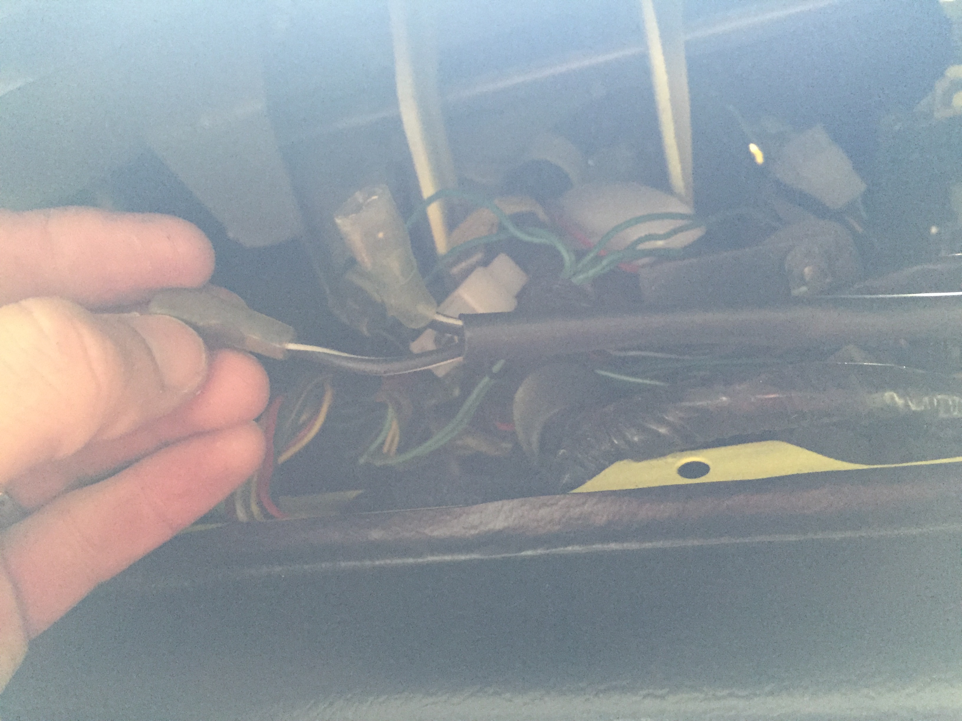

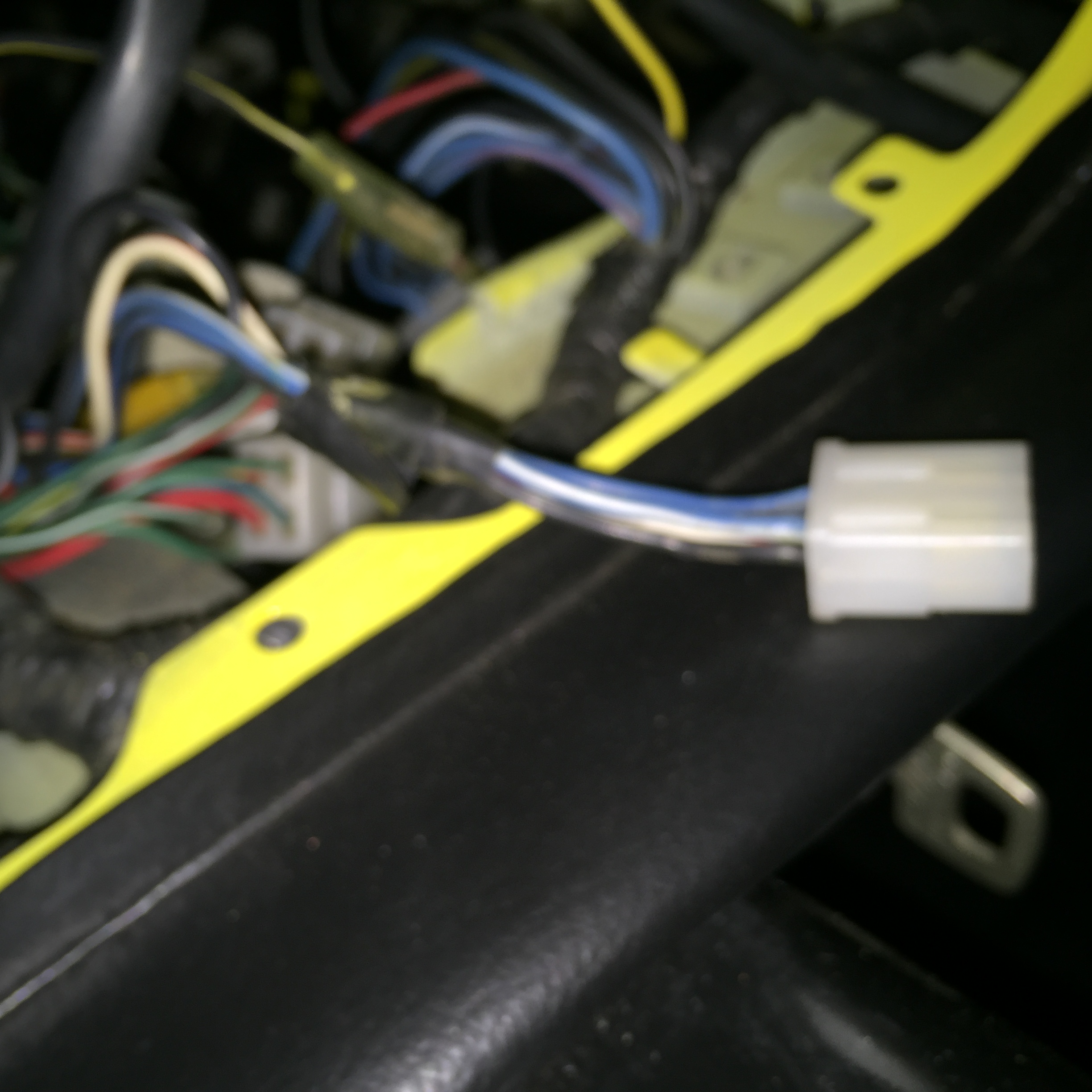

I have figured out most of it, I still have a few wires and one small harness connection behind the gauges/cluster that I'm not sure about. The connection behind the cluster has four wires to it, female, blue/ black, black, blue/ white , white/red. Any ideas?
Also, behind the gauges there are two small holes where it looks like it's missing two bulbs like the rest. Is that what I'm missing, two bulbs? Other circuit board doesn't have brass outlined like the rest is why it's throwing me off.

PostPosted: Mon Jan 04, 2016 8:17 pm
Posts: 262
Ok, got my answer on the gauge cluster missing lights. Thanks
I just need to figure out that 4 wire connector.

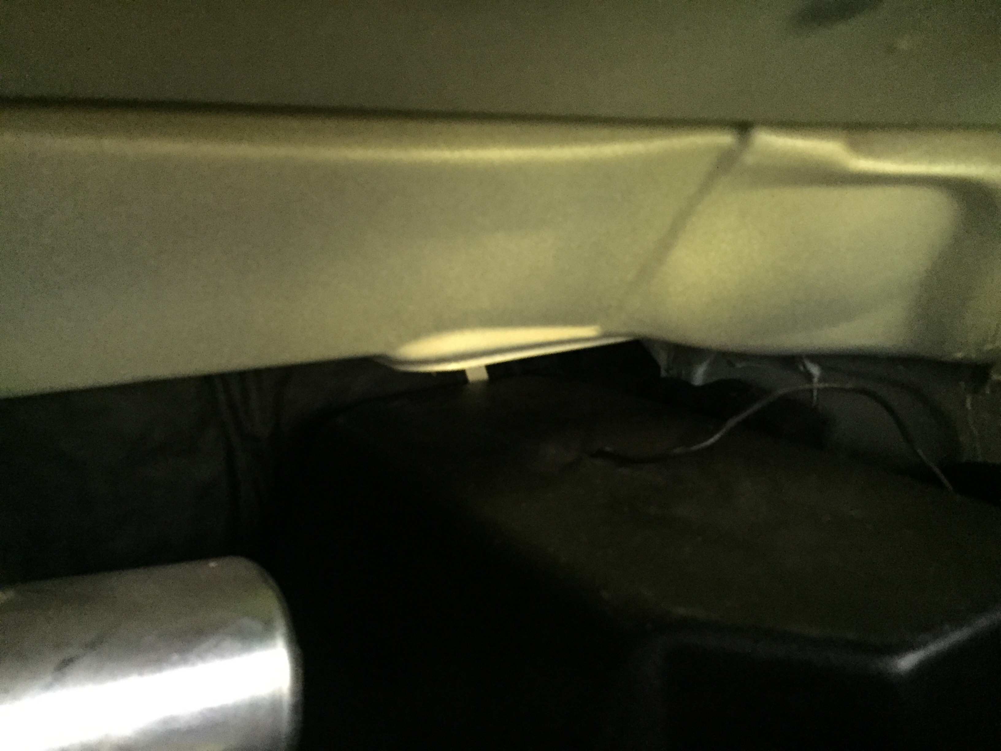

PostPosted: Mon Jan 04, 2016 8:40 pm
Engine speed sensor???
PostPosted: Mon Jan 04, 2016 9:18 pm
Posts: 262
Forgive my stupidity for if this sounds really stupid, I'm not a mechanic. Is the speed sensor located under the dash? One of those electrical boxes that are positioned back to back?
If not, where is the connection for that?
Thanks for the help.
PostPosted: Mon Jan 04, 2016 10:17 pm
Not sure where it is under the dash, t took mine out when I put in a V8. I simply went to the wiring diagram and looked for a four wire connection with the colors of the wiring, I found it in less then 15 seconds. All of your answers are there.

In the picture, the black box, that is the speed sensor.

Last I will try to help you, you really need to read the wiring schematic. Your pic is hard to see all the colors. I found a 4 pin comment or that is black, blue, blue/black tracer, white/red tracer. Are those the colors? If so it goes to a A/C relay.

Luvr8, it's black, blue/white tracer, blue/ black tracer, and white/red tracer.
X2 A/C relay.

I just got back on to this project. I have two LUV manuals and have been looking at the diagrams for the past three days. Thank you Luvr8, it was the plug for the AC relay.
Also, I have been trying to figure out why I don't have power going to the starter solenoid upon ignition start. Three days of this, off and on. So I looked at a lot of things, taking the cluster out and looking at everything. Finally, I figured out, there is additional clutch wiring aside from the normal switch. The two black wires with the white stripe that I had asked about on an earlier post here, those wires go to another clutch starter switch that is below the first clutch switch, if that makes sense. I hooked it up and it worked.
To 3rdluvnext, thank you for that video. It helped me to figure out the correct connection to two wires directly behind the cluster.
