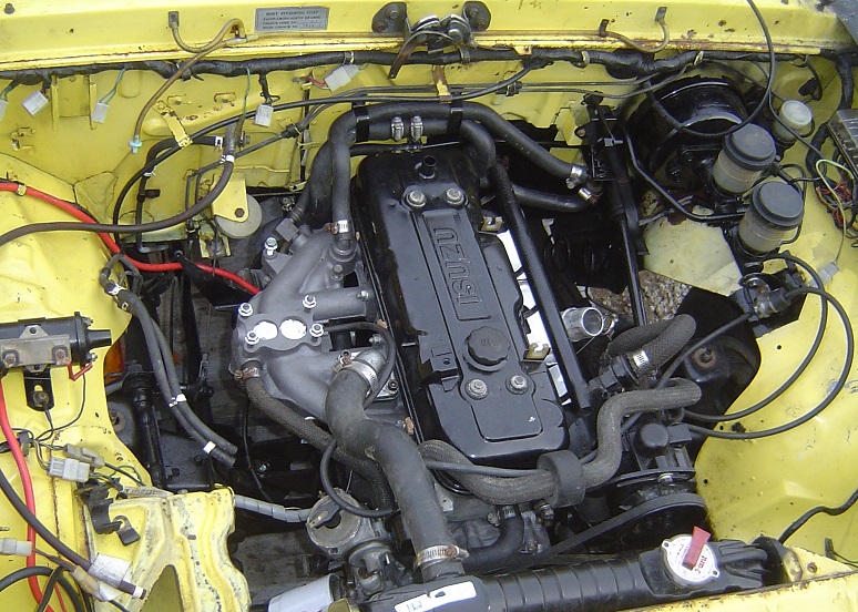

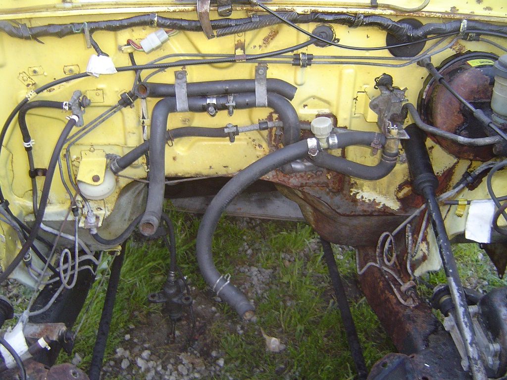

I noticed my gauge getting higher and my heater fan seems to have a short somewhere the fan only seems to only turn on/ work when i'm driving not when i sitting in the driveway unless i just pulled up and left it running .. I get heat from my defroster tube but no heat when the heater is on even when warmed up.
so i'll be tearing into it flushing it out... just seeing this post but here s couple pics
