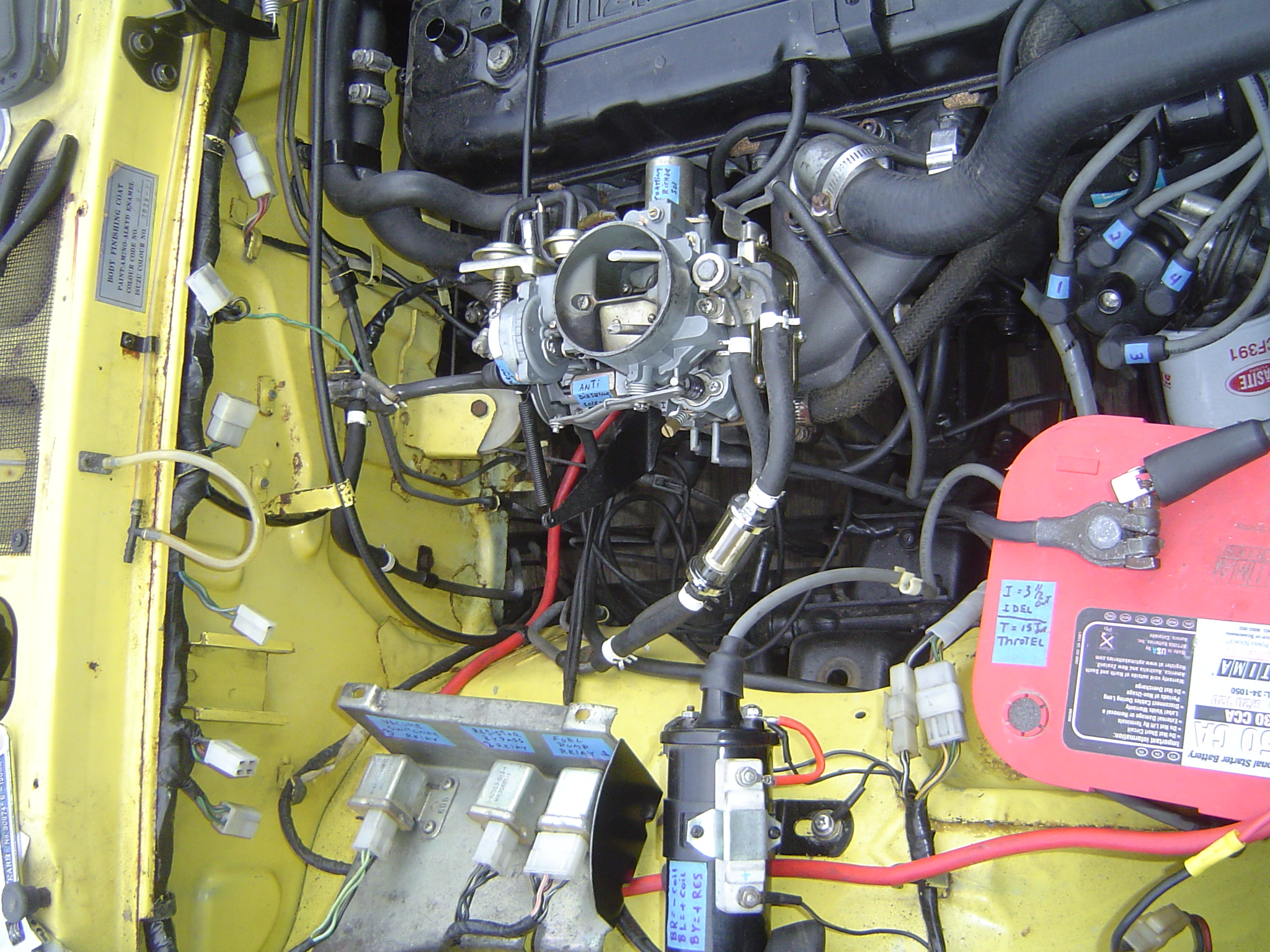

I'm sure your getting close & matter of dialing it in ...I believe you recently upgraded to a Weber carb now... right.
I'm still using a stock carb
I would take... love4theluv...up on his offer... when dialing mine in, i went up near Sacramento to get some parts and compare what we both had going on and was quite helpful to both of us.
& after getting it RUNNING GOOD & PASS SMOG , I wrote down some notes in a few places on blue tape near by & left it there till i knew what was what
