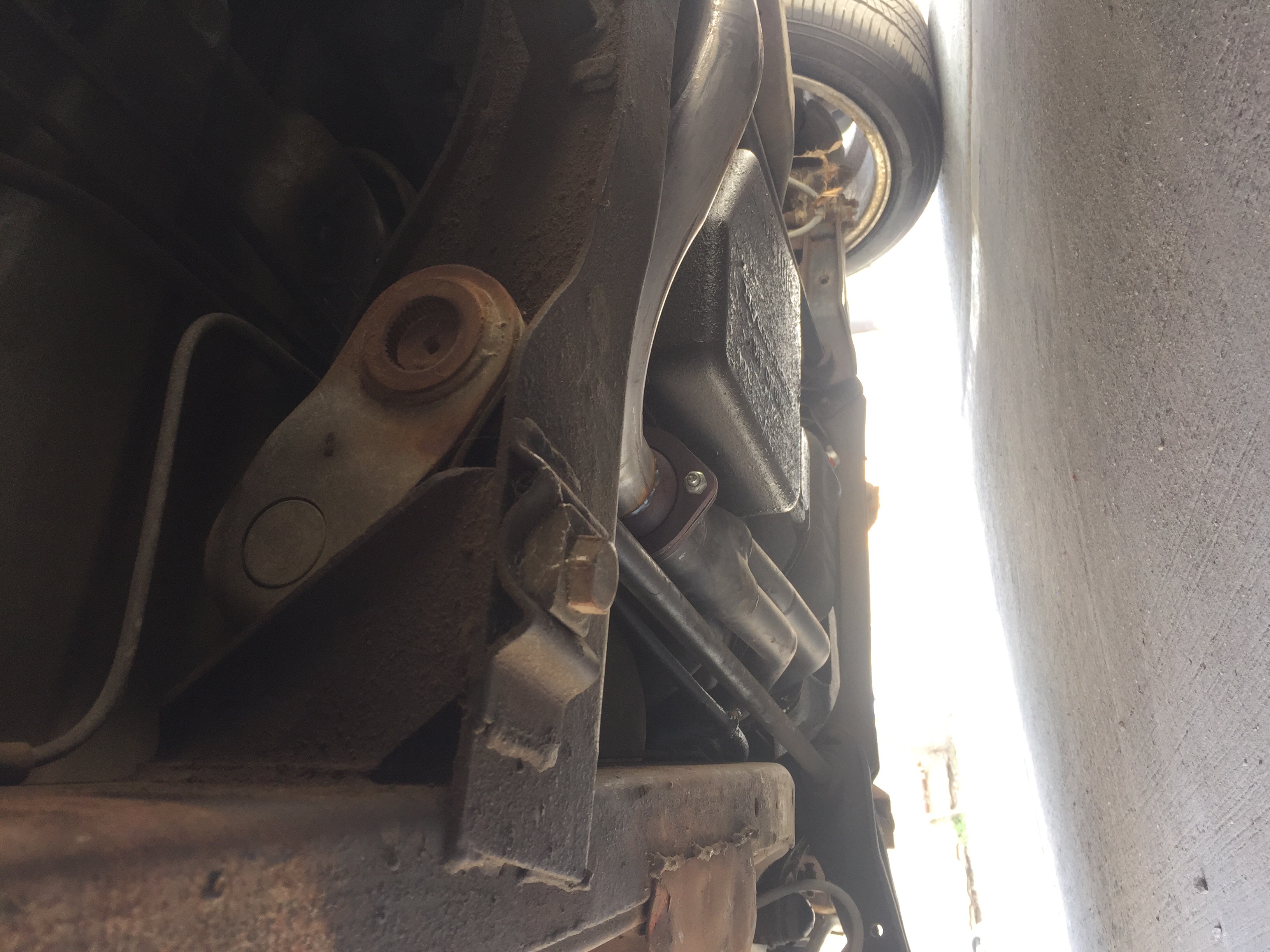

I think i found the part thats connected to the adjuster is it this one(pic)........................

That big hex head is the adjusting bolt. From the angle of the lower control arm & the adjuster in the picture the truck has already been lowered, so there may not be much adjustment left.

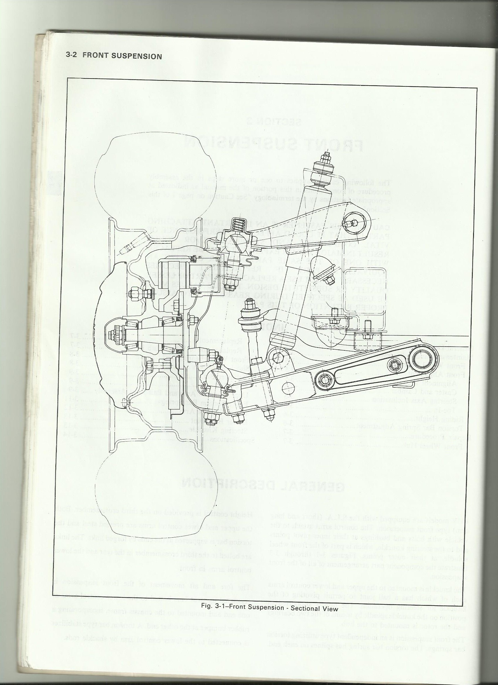

Look at where the lower control arm contacts the bump stop- any gap is what it can be lowered. If you continue to turn the adjuster after contacting the bump stop you will just unscrew the adjuster bolt from the adjuster & remove the torsion bar tension from the suspension- you don't want to do that. When you lower the truck down to the bump stops you will have no more up suspension travel, only downtravel. Ride will be unbelievably harsh, especially so if you're running high pressure tires. The shocks no longer function on compression because the suspension is bottomed, a bump can actually bounce the front tire off the ground, which can be unsafe at speed. You can grind down the bump stop or even remove it to gain a bit more uptravel- or lowering- but you will eventually reach the limit of this type suspension geometry & only increase the harsh ride & associated safety issues.
