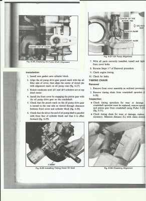

This is what '78 FSM says, may or may not be different than the Haynes. Note the three referenced diagrams are out of sequence.
As to the slot not being parallel: it could be the pistons are not quite at the top of the stroke. The crank key should be straight up but using that to determine actual TDC might allow the crank to be turned just enough to cock your distributor drive slot.

Timing the oil pump is really very easy. If the timing chain is not installed then all that matters is having #1 and #4 Pistons all the way up at top of engine block. The key on crank should be at 12:00 clock position. Install the timing cover and torque bolts to spec.
If you look at the gear on oil pump the shaft coming out of it is slotted and that the slot is offsett to one side. (This means the distributor shaft will only drop in one way once pump is installed). Position the oil pump kinda into its location on timing cover and then right before installing the pump onto timing cover just turn the pump gear until the smaller side of the offset is facing toward rear of engine. Take a flashlight and look down the distributor tube on timing cover while installing the oil pump and make sure the smaller side of offset is facing rear of engine once the pump is put into place. Take a look at the pictures you posted, the top left picture is all you need and shows you the final placement of that slot. Don't worry about all the other pictures they are confusing. Hope this helps.
